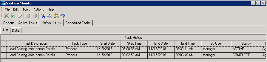

I have 3 processes and 1 report that i cancelled a while ago and they are stuck on “cancelling” on the System Monitor.
I know i can restart my agents from OE Console, but if i remember correct, there is a conversion program i can run from our Admin Tools that deletes those active task without restarting agents and deleted Scheduled Tasks. Anyone know which program number that is?
There is no conversion to remove tasks that are stuck cancelling in the System Monitor
Restarting the taskagent and processserver appserver processes is the official process to remove them.

That would be awesome to have even in E10 land! I occasionally have to kill the backflush process since it doesn’t cleanly disappear. On occasion other items too but that one is more common.

For what it’s worth a task agent restart doesn’t actually kill the active backflush task and restart it cleanly which is the issue I was referring to. It stays as active in SQL so when the task agent restart occurs, it gives an error saying a similar process is already running but in reality it’s not. My solution has been to kill the task SQL side prior to the task agent restart.
