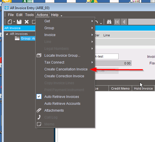

Create a Cancelation Invoice. It will reverse all GL transactions
Its on the Actions menu in an AR Invoice Entry group
