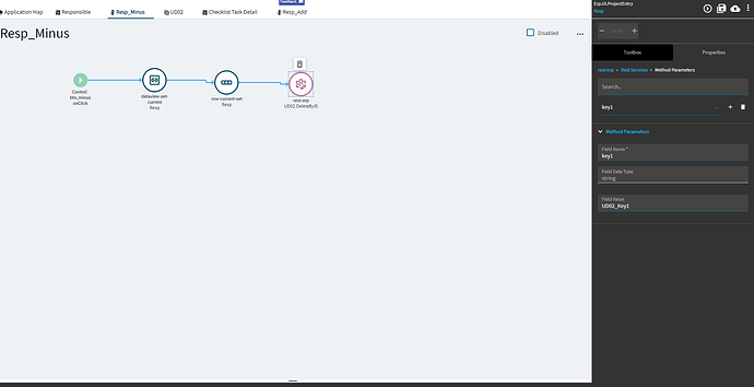

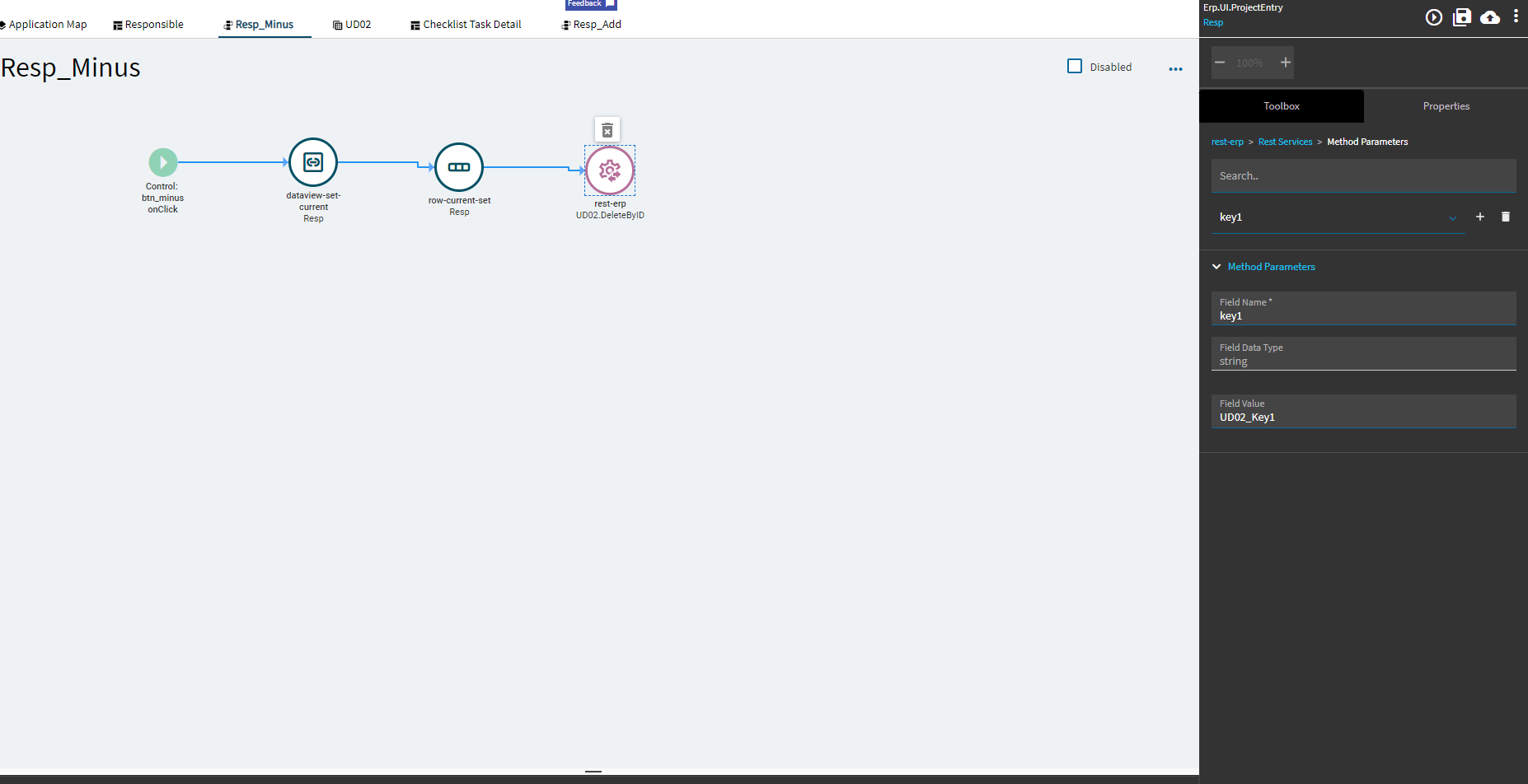

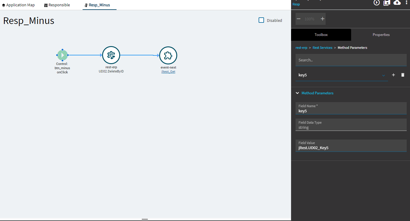

Now i simply want to be able to use two buttons ive added to the grid to be able to 1: Add a new Record in UD02, 2: Delete a Record in UD02. Ive tied both to two different events, for the sake of simplicity i will just refer to my troubles with deleting a record first:
I keep receiving the following error:Parameter key1 is not found in the input object

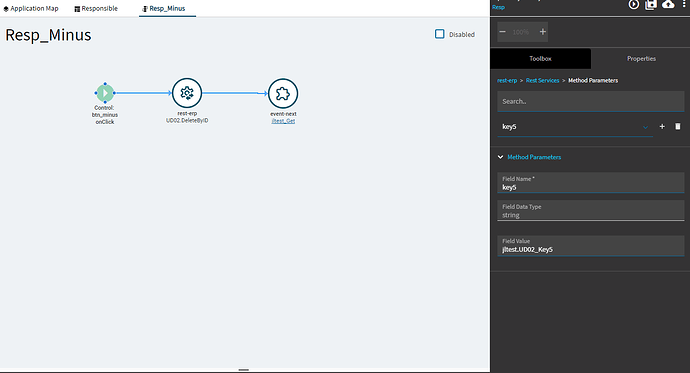

My understanding is i link the service name and service operation like so:
Then i apply all five keys in my UD02 table in my Method Parameters
(I have tried with and without the field Values that i set to UD02_KeyX where X is the KeyNum)
For the record I have been able to delete a record using the row-delete block but this only deletes it from the data view and my attempts to use a rest-erp update after the row-delete failed
I believe this is supposed to be a simple thing to do???, however i have been unable to do this for a week, any help would be much appreciate kinetic 2023.2 has been a steep learning curve, am i lacking a fundamental concept?

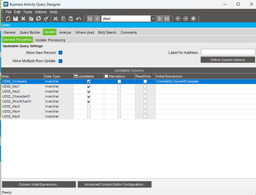

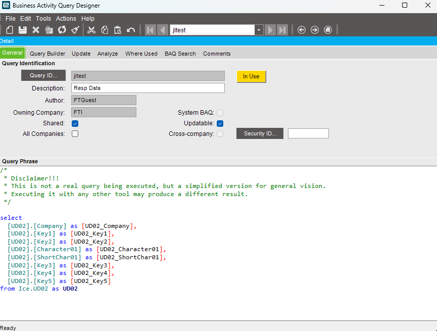

For further updates this is my UBAQ:
I believe this is the correct way to use an event to delete a record from my Grid however i receive the error “Record not found” no matter what i do. Ive tried just attaching keys 1-5 to method parameters. Ive also added Company, ShortChar01, and Character01 with little to no success.

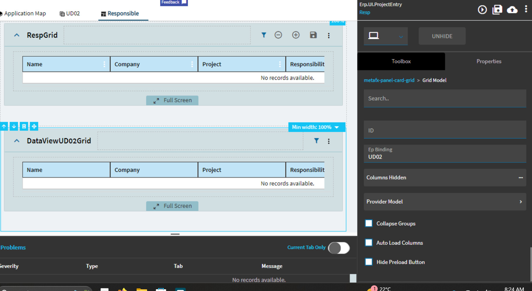

Soo I spent all morning trying to work out how:

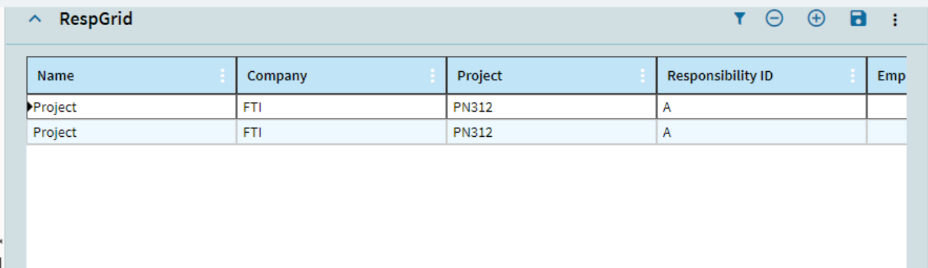

This is my orginal grid in preview with a uBAQ linked to a dataview with both attached. as you can see its displaying data:

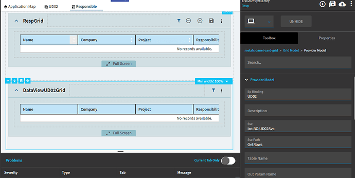

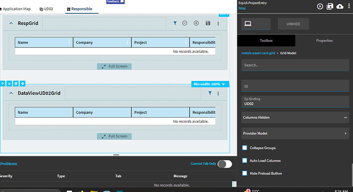

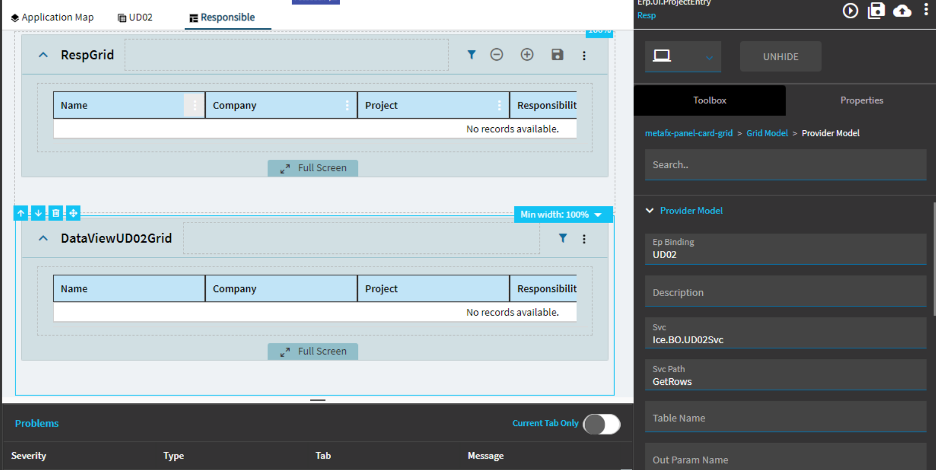

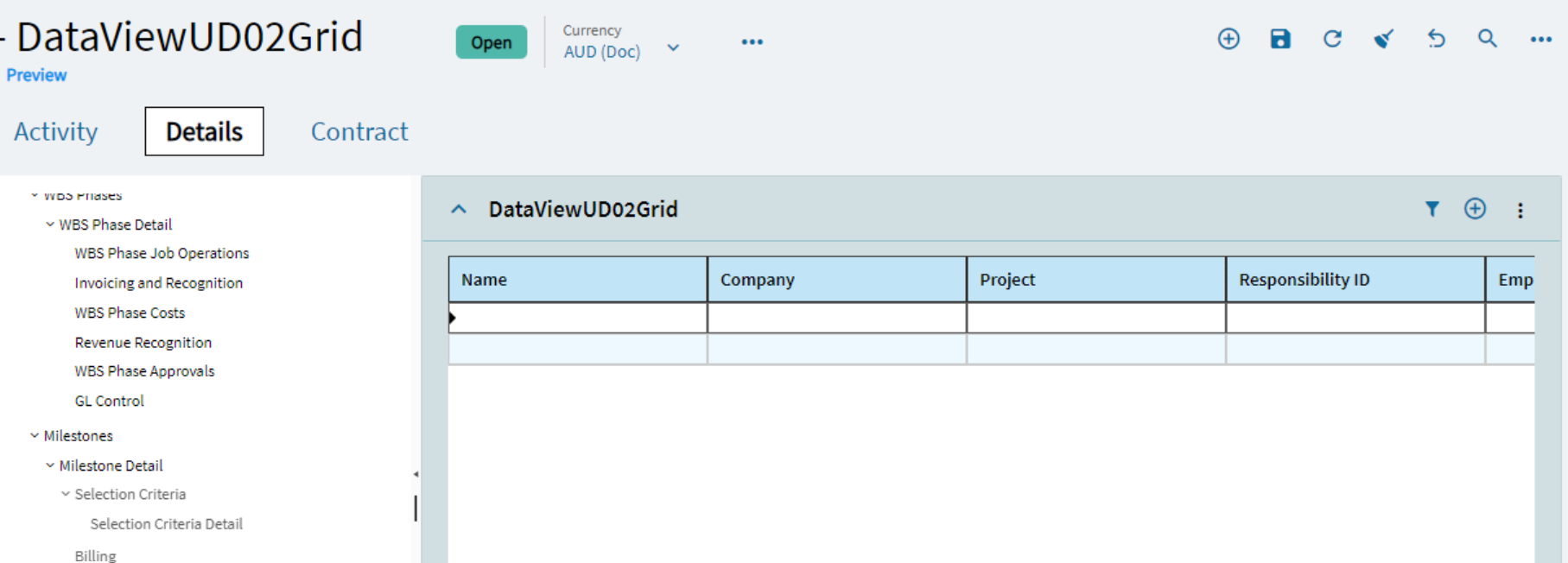

I made a separate grid using a different dataview named “UD02” and linked UD02 to it

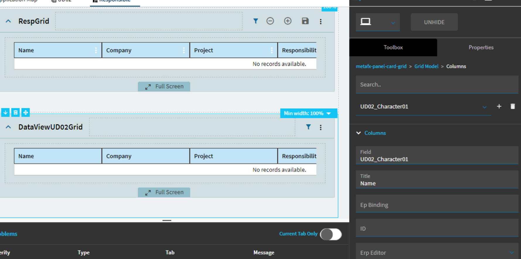

However In preview the table displays empty rows???
Your columns have UD02_ prefix, which is valid when feeding from a BAQ datasource, but those prefixes should be removed now.
Yes that was it, Thankyou everyone. ill set up my events and if i get everything working this should be a solved problem. Can’t believe it was that simple of a solution here I was doing too much. Out of curiosity what scenario would you need a uBAQ linked to a grid???

Im sorry where is this exactly. I tried just adding buttons to the grid and using a rest-erp.DeleteByID but that’s still having issues. maybe i misunderstood what you meant by this?

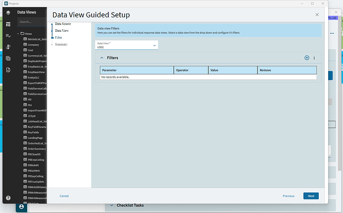

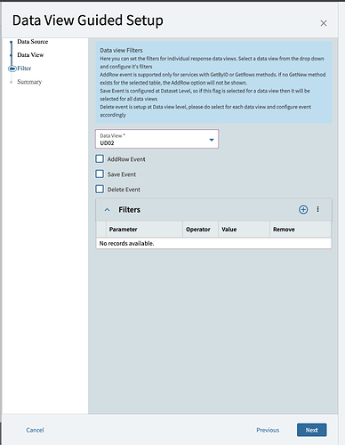

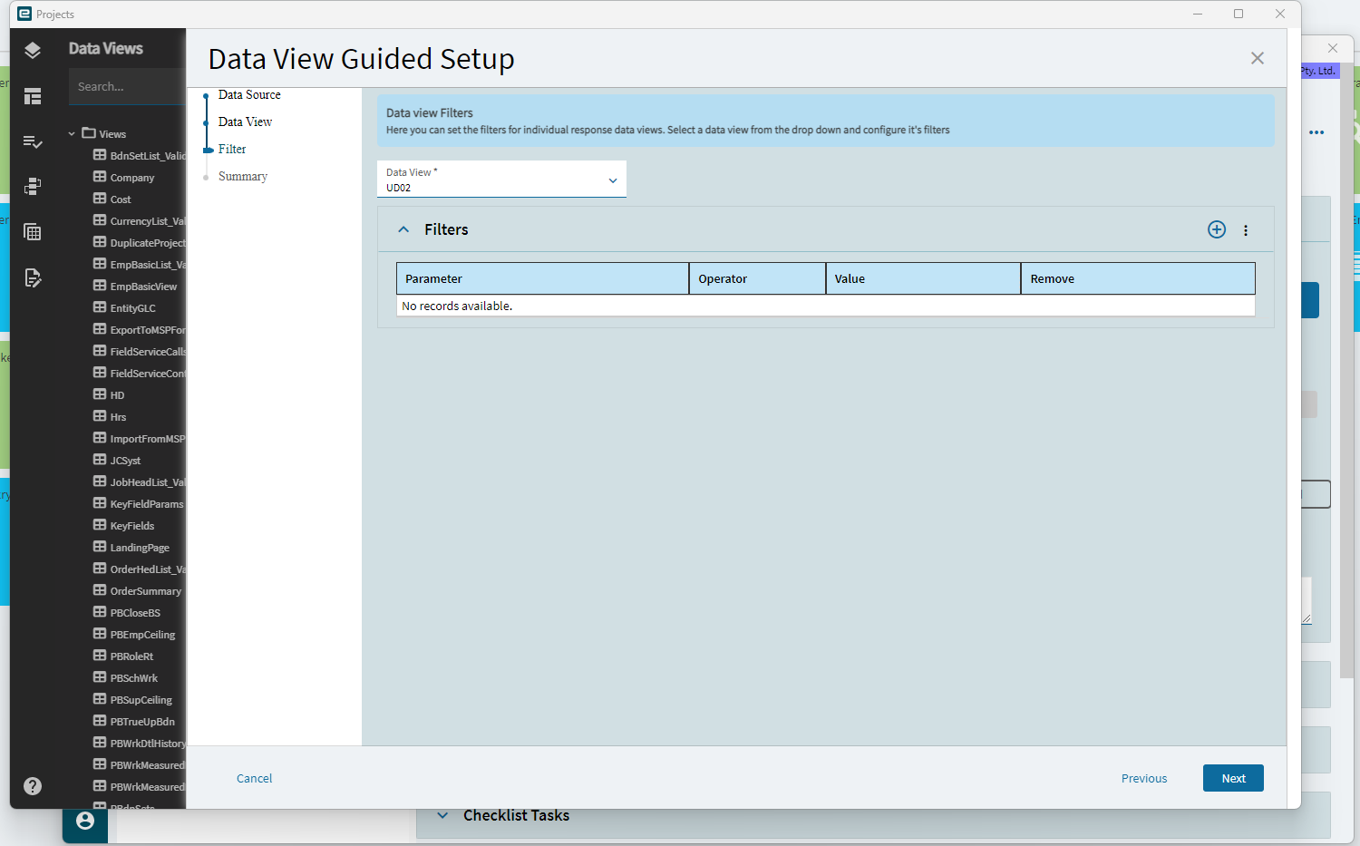

Create the UD02 dataview using the guided setup using Ice.BO.UD02Svc and GetRows method, then on the filter section of the guided setup, you can select the additional events you want created. You’ll still have to map a button to the event, but the event will by system created.
I don’t seem to have that?
Is this a version difference?

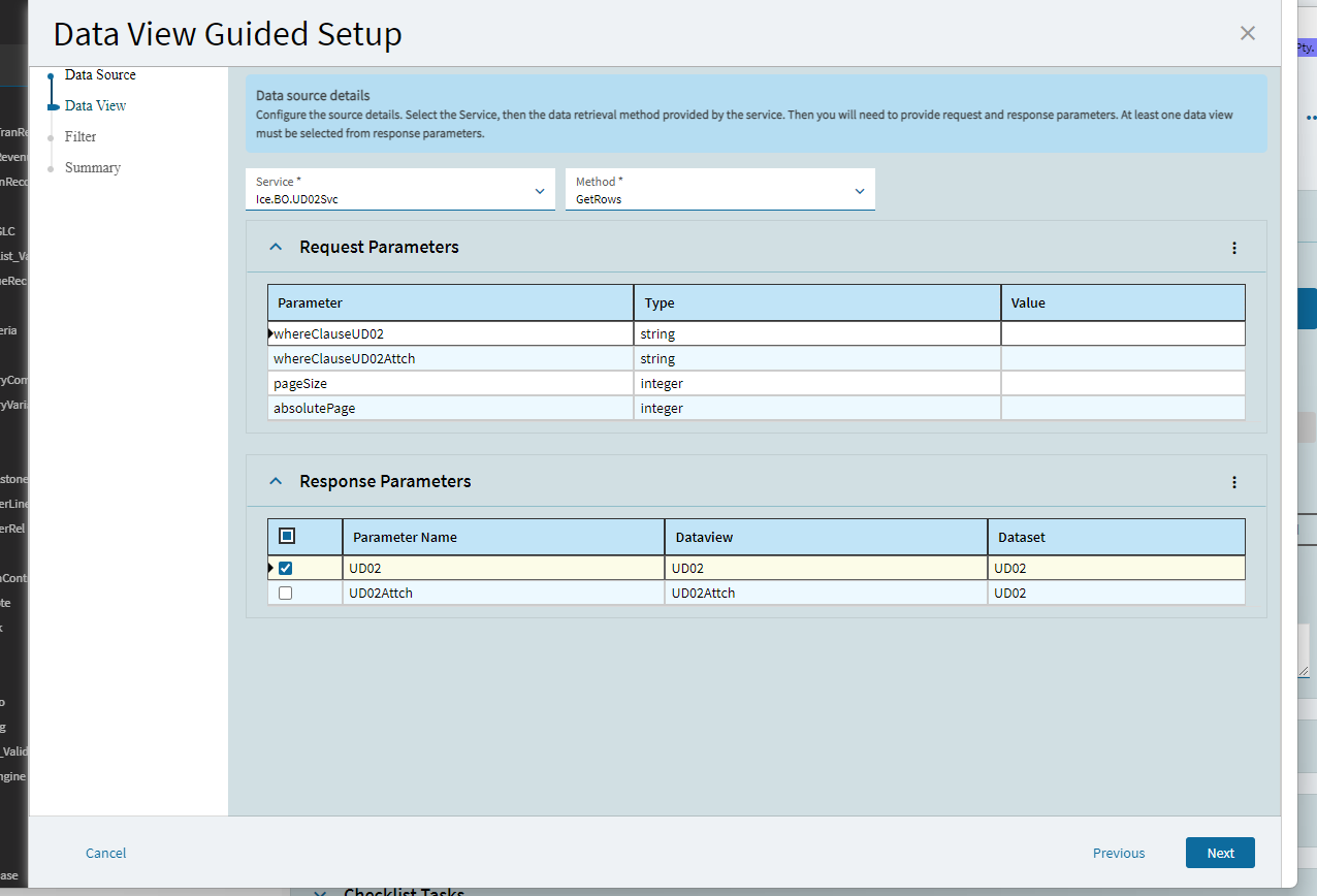

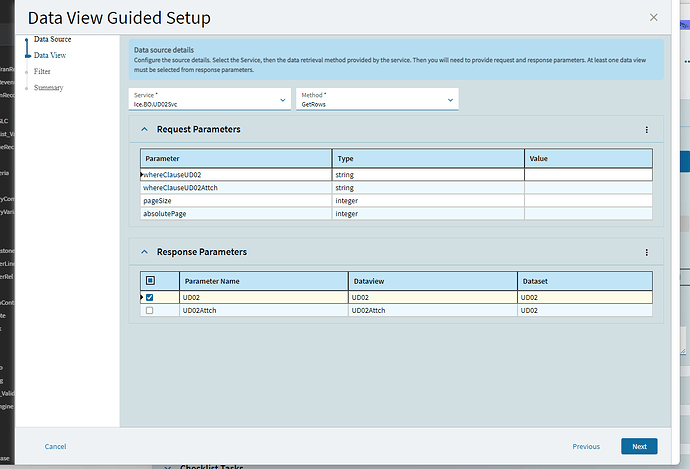

What did you select for response parameters on the previous screen from this one?
I tried UD02, Then UD02Attch, then i ticked both. same result :man_shrugging:
That matches what I threw in to get my screenshot above. I’m on 2025.2.7
