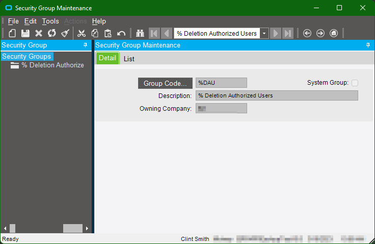

  1. Create Security Group for this

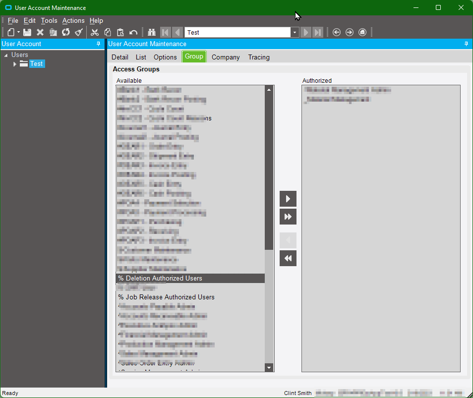

  2. Assign User to the appropriate group

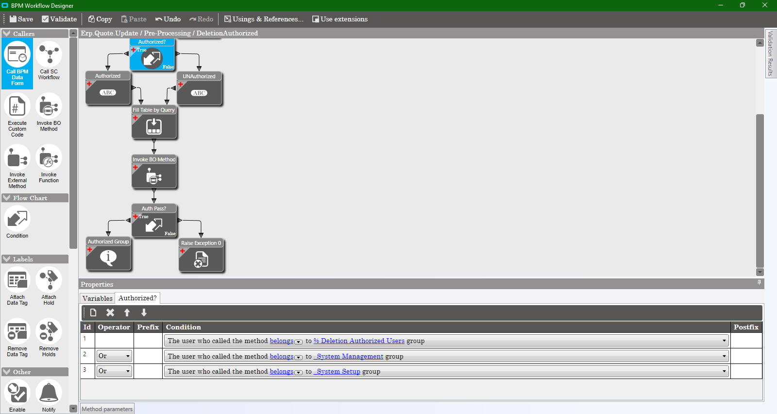

  3. Create Pre-Processing BPM on Customer > Delete > Update
The bottom bit is all is needed for your scenario and then just throw an exception. I have mine logging who was doing it you can see the flag being set then saving the info to UD02 and then either allowing or raising an exception last control block.
