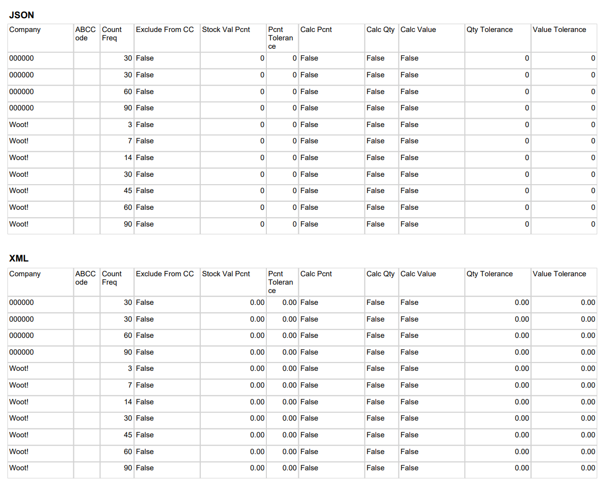

Then I made a simple BAQReport, and generated it for design.
In the designer, I added a new dataset, and chose “Use dataset embedded in my report.”
Edited the query for the DataSet: (only choosing top row and field)
="DECLARE @json NVARCHAR(MAX);
SELECT TOP 1 @json = [Calculated_Json] FROM dbo.[BAQReportResult_" + Parameters!TableGuid.Value + "];
SELECT
    jsonParsed.[Company],
    jsonParsed.[ABCCode1],
    jsonParsed.[CountFreq],
    jsonParsed.[ExcludeFromCC],
    jsonParsed.[StockValPcnt],
    jsonParsed.[PcntTolerance],
    jsonParsed.[CalcPcnt],
    jsonParsed.[CalcQty],
    jsonParsed.[CalcValue],
    jsonParsed.[QtyTolerance],
    jsonParsed.[ValueTolerance]
FROM OPENJSON(@json, '$.ABC')
WITH (
    [Company] NVARCHAR(MAX),
    [ABCCode1] NVARCHAR(MAX),
    [CountFreq] INT,
    [ExcludeFromCC] BIT,
    [StockValPcnt] FLOAT,
    [PcntTolerance] FLOAT,
    [CalcPcnt] BIT,
    [CalcQty] BIT,
    [CalcValue] BIT,
    [QtyTolerance] FLOAT,
    [ValueTolerance] FLOAT
) AS jsonParsed;"

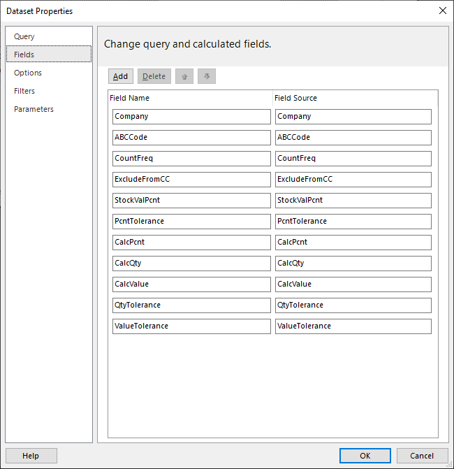

Added the fields:

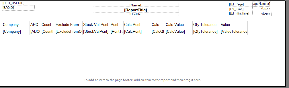

And then proceeded to make the report:

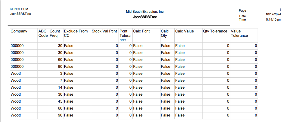

And ran the report:
Thus endeth the demo.
BAQ, XML, RDL → JsonSSRSTest.zip (25.2 KB)

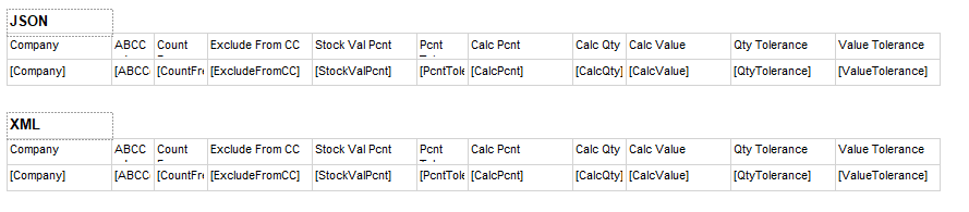

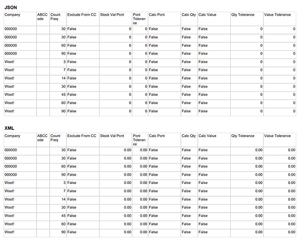

:fire: Multiple DataSets → JSON & XML in same Report!!! :fire:
Angry Season 3 GIF by The Office
I made a BAQ, with two calculated fields Calculated_Json, and Calculated_XML.
Here is how it is generated, using a UBAQ with a customization on GetList:
Post → Ice.[Company]/AlternativeDSTests.GetList->GrabABCAsJsonAndXML
//using Newtonsoft.Json;
//using System.Xml.Linq;
//Recursive Func<T>...
Func<object, string, XElement> JsonToXml = null;
JsonToXml = (json, rootName) =>
    var jObject = json as JObject;
    if (jObject != null)
        XElement element = new XElement(rootName);
        foreach (var property in jObject.Properties())
            element.Add(JsonToXml(property.Value, property.Name));
        return element;
    var jArray = json as JArray;
    if (jArray != null)
        foreach (var item in jArray)
            element.Add(JsonToXml(item, "Item"));
        return element;
    return new XElement(rootName, json.ToString());
result.Results.Clear();
var someData = Db.ABCCode.ToList();
string jsonData = JsonConvert.SerializeObject(
          new
              ABC = someData
          }).Replace("$", String.Empty).Replace(Session.CompanyID, "Woot!");
var jsonObject = JsonConvert.DeserializeObject(jsonData);

Simple BAQReport, Generated it for design.
In the designer, I added two datasets, and chose “Use dataset embedded in my report.”
Query for DataSetJSON: (only choosing top row and field)
SELECT
WITH (
    [CountFreq] INT,
    [CalcPcnt] BIT,
    [CalcQty] BIT,
    [CalcValue] BIT,
) AS jsonParsed;"
Query for DataSetXML: (only choosing top row and field)
DECLARE @xml NVARCHAR(MAX);
SELECT TOP 1 @xml = [Calculated_XML] FROM dbo.[BAQReportResult_" + Parameters!TableGuid.Value + "];
DECLARE @xmlData XML;
SET @xmlData = CAST(@xml AS XML);
SELECT
    x.value('(Company)[1]', 'VARCHAR(100)') AS [Company],
    x.value('(ABCCode1)[1]', 'VARCHAR(10)') AS [ABCCode1],
    x.value('(CountFreq)[1]', 'INT') AS [CountFreq],
    x.value('(ExcludeFromCC)[1]', 'BIT') AS [ExcludeFromCC],
    x.value('(StockValPcnt)[1]', 'DECIMAL(10, 2)') AS [StockValPcnt],
    x.value('(PcntTolerance)[1]', 'DECIMAL(10, 2)') AS [PcntTolerance],
    x.value('(CalcPcnt)[1]', 'BIT') AS [CalcPcnt],
    x.value('(CalcQty)[1]', 'BIT') AS [CalcQty],
    x.value('(CalcValue)[1]', 'BIT') AS [CalcValue],
    x.value('(QtyTolerance)[1]', 'DECIMAL(10, 2)') AS [QtyTolerance],
    x.value('(ValueTolerance)[1]', 'DECIMAL(10, 2)') AS [ValueTolerance]
FROM
    @xmlData.nodes('/Root/ABC/Item') AS temp(x);
Added the fields to both DataSets:
The report:
And ran the report:
Files → AlternativeDSTests.zip (26.8 KB)
Thus endeth the second demo.

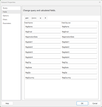

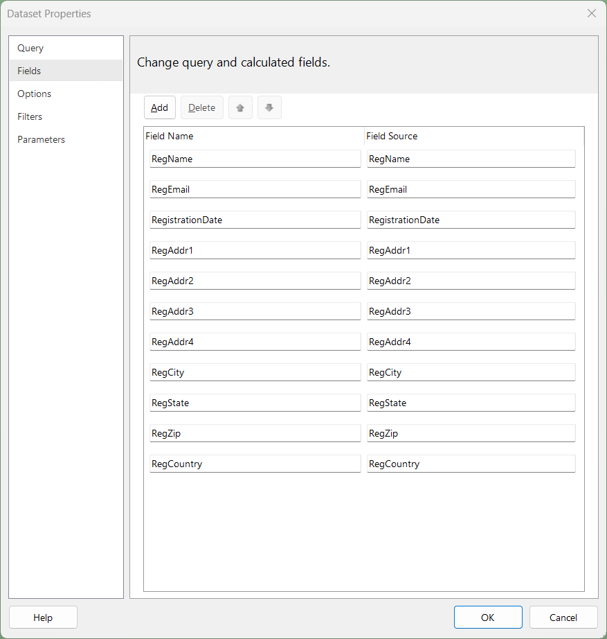

Was going to post into Experts Corner but can’t make post there yet :slight_smile:
Dataset: expression to connect to stored procedure and pass in parameters.
DECLARE @Month  int;
DECLARE @Year   int;
DECLARE @Format int;
DECLARE @SQL    nvarchar(4000);
SET @Month  = " & CStr(Parameters!iMonth.Value)  & ";
SET @Year   = " & CStr(Parameters!iYear.Value)   & ";
SET @Format = " & CStr(Parameters!iFormat.Value) & ";
SET @SQL = 'EXEC [dbo].[sp_TrailerRegistrations] @Month = @Month, @Year = @Year, @Format = @Format';
EXECUTE sp_executesql @SQL , N'@Month int, @Year int, @Format int ', @Month , @Year , @Format
Couldn’t help myself lol
DECLARE @Month  int;
DECLARE @Year   int;
Ummm, thx :smiley: once I had it edited I trimmed the extra whitespace :stuck_out_tongue:
