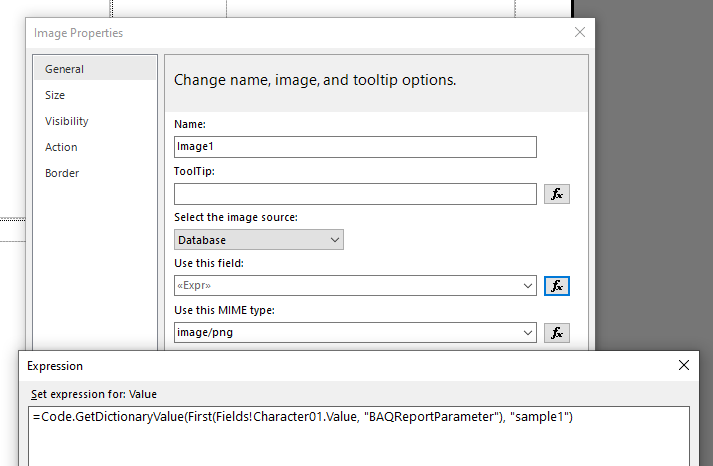

I decided to use VB.Net in the report to grab the data from the dictionary json.
Well with a little “prompt engineering” in ChatGPT, I ended up with a nice little function you could add in the code section of an SSRS report. You can then call this little function and pass it the BAQReportParamter.Character01 value, and the “key” and it will give you back the image data.
=Code.GetDictionaryValue(First(Fields!Character01.Value, "BAQReportParameter"), "sample1")

    Make sure you set your MIME type in the report, and chose "Database" as the location instead of "Embedded".
Add this to Code section in SSRS report:

Expression for SSRS Report to get the value by key
(Make sure you set your MIME type in the report, and chose “Database” as the location instead of “Embedded”.)

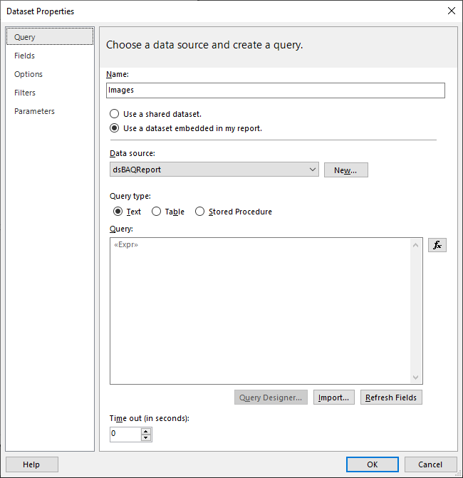

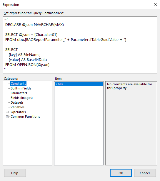

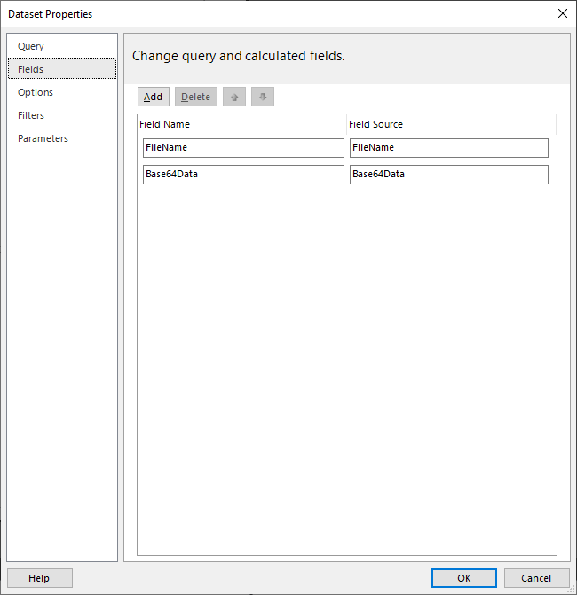

Messing around with this today, found a way to stay in SQL Land with no VB.
Add a dataset → Images
Use a dataset embedded in my report, chose appropriate.
Query →
 DECLARE @json NVARCHAR(MAX)
 SELECT @json = [Character01]
 FROM dbo.[BAQReportParameter_" + Parameters!TableGuid.Value + "]
 SELECT
    [key] AS FileName,
    [value] AS Base64Data
 FROM OPENJSON(@json)
Fields →
FileName → FileName
Base64Data → Base64Data

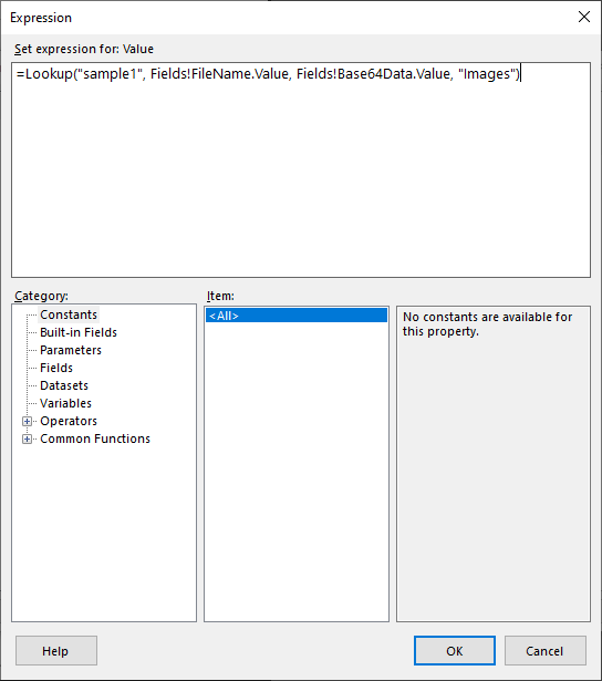

Add Image to report, chose mime type.
Expression →
=Lookup("sample1", Fields!FileName.Value, Fields!Base64Data.Value, "Images")

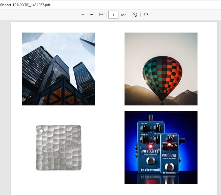

Example with 4 Images →

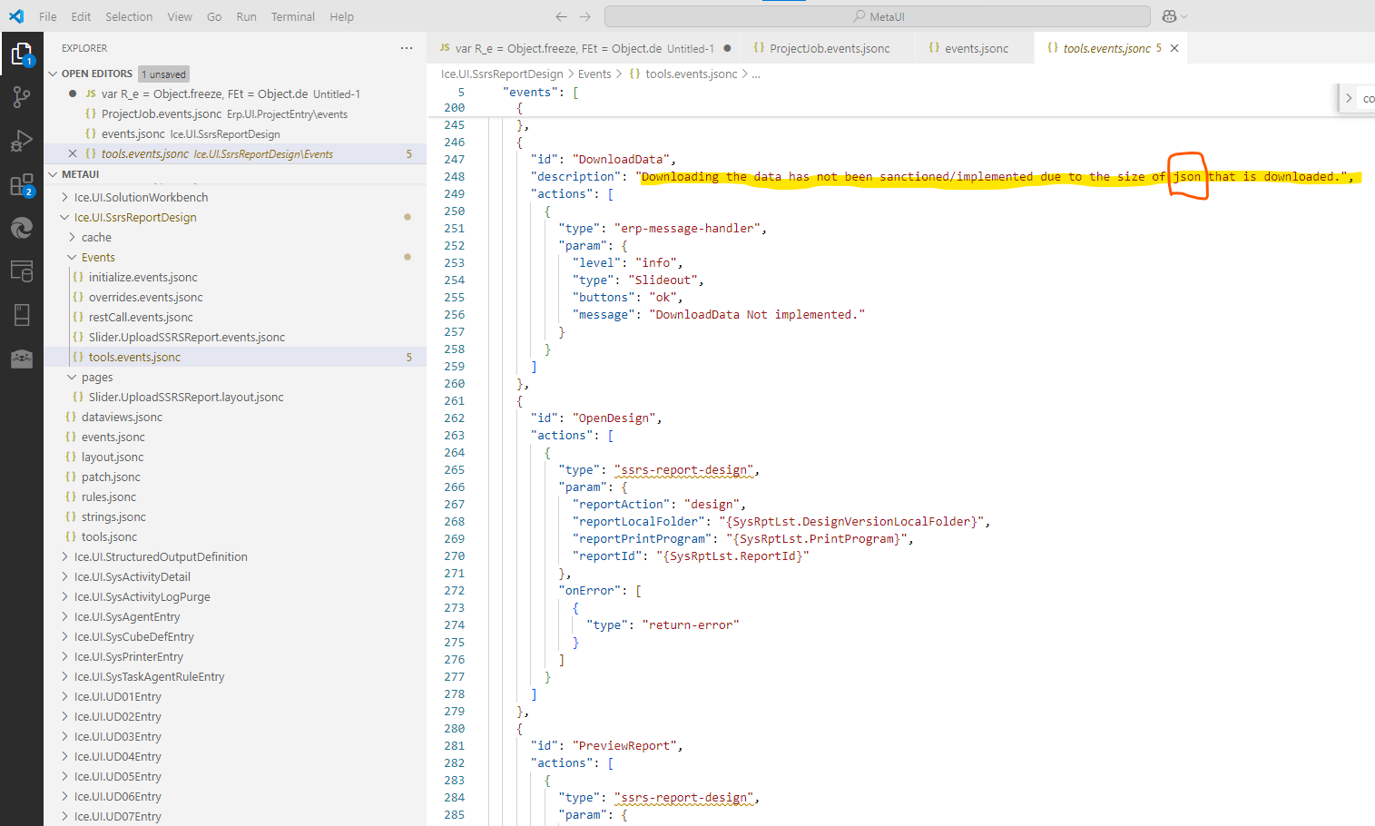

Couldn’t they make all SQL in RDLs be FROM OPENJSON(@json), and replace RDD to temp tables with BAQs to json output? :thinking:
Probably, but that sounds highly innefficient. I am however extremely glad this exists for the situations where we can make use of it.
hmmm… they are up to something…
I bet they intend to zip it.
but how could it work for local preview of OOB RDL having SQL expressions? :thinking:
