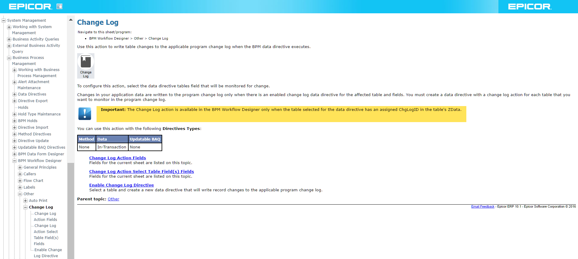

Change Logs used to be handled with BAMs in E9, but in E10 they removed
BAMs and added the functionality to BPM’s. Basically, you create an
In-Transaction Data Direcive and use the Change Log Block. There is
information in the Help Files, see below.

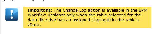

But there’s no ChangeLog block in the designer for that table.
Perhaps because:
Sorry, Calvin, I made an assumption this morning while not in front of the
software that the Closed field would be part of the FiscalCal table, looks
like you are correct and it’s GLBookPer.ClosedPeriod. The stinks that
GLBookPer isn’t part of the ChangeLog tables, I’m surprised because you
would think from an audit standpoint other would have wanted this logged as
well.
