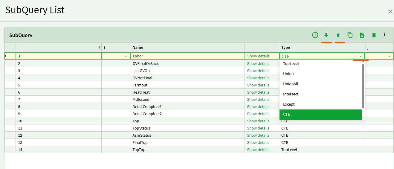

Diagnosing Complex BAQ Slowness Kinetic
Working in the Kinetic BAQ editor is terrible. I want the features they added put into classic. Saving a BAQ is a nightmare. It takes forever, lags, errors out, sometimes does save, sometimes produces a handful of different deadlock errors.
That all sucks, but fine, I have to deal with it. I am looking for any new ways to diagnose where my BAQ is sucking up all the time. I am running a BAQ that references another BAQ. It works, but takes 30-60 seconds to run.
This set of BAQs attempts to apply some kind of milestone logic based on our job operation statuses. There is a lot going on. The referenced BAQ is JobStatus:
JobStatus.baq (35.8 KB)
This looks at the assemblies in a job, and assigns the lowest status to the entire job, based on the lowest status of the unfinished assemblies.
The BAQ that uses JobStatus is WIPvsSalesValue.
WIPvsSalesValue.baq (65.2 KB)
This recreates the WIP report. I think I got the base for this from someone on here (thank you! I still don’t get CTEs). Then it combines the sales order value of each job, so we can see a WIP value and a Sales order value. Finally, it applies a status from JobSatus to each job, allowing us to put into buckets the WIP value and Sales Value. For example, we can get a total of all the WIP value for jobs sitting at the status ā€œFarmoutā€, and we can see the associated sales value for that set of jobs.
This is far from perfect, and the magic lies in how we set the job status flags. We are still fine-tuning those rules. In the meantime, what can I do to see where the major time is being used up in this BAQ? Is there feature in Devtools that allows me to track this level of timing details? I’d like to see how long each step takes, so I can focus my efforts. It takes so long to make a change to a BAQ, then get it to actually save that change. Just adding Company back in to this as a key field took nearly 30 minutes and 6+ tries of clicking save. Waiting for the blue bar to go away, and then checking to see if it saved. If I could edit this BAQ in classic, I totally would.
Thank you for your time!
Nate

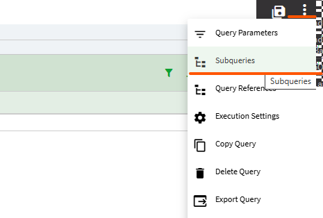

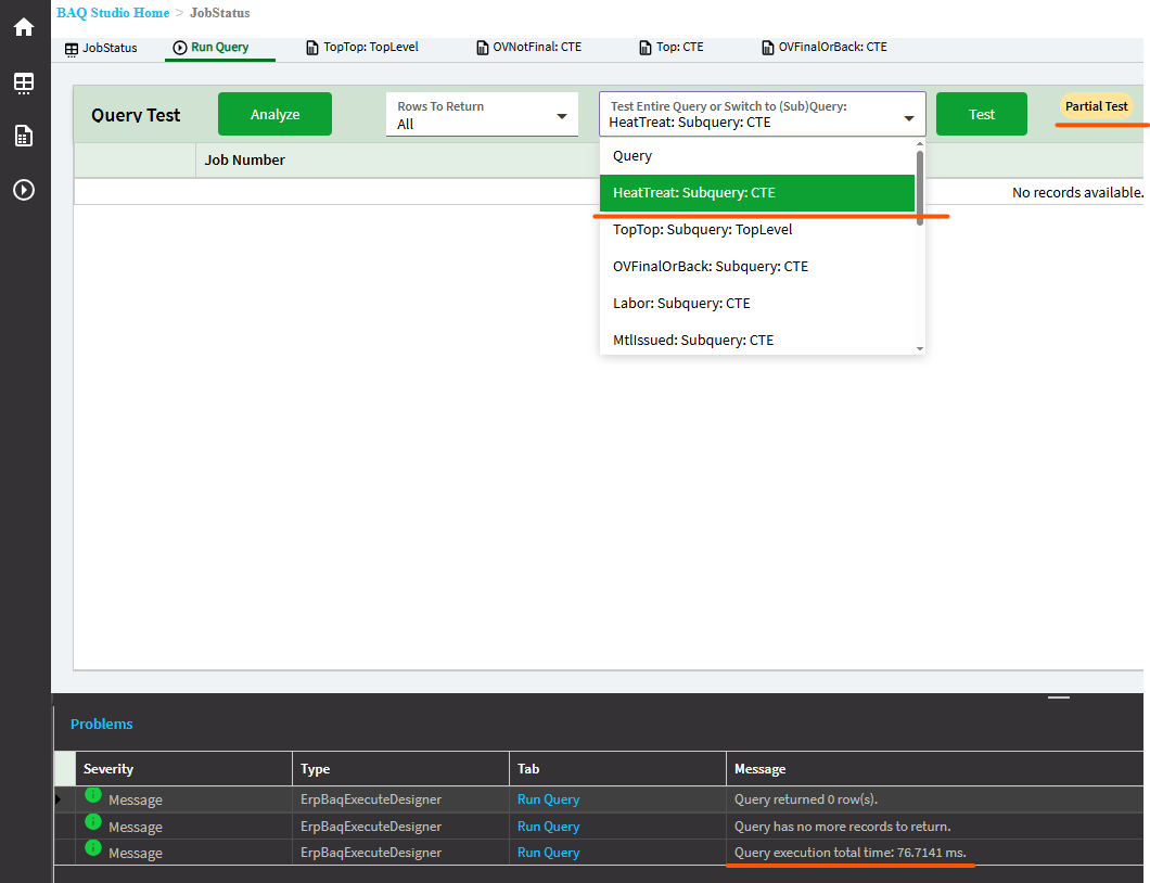

So you can see the execution time when you run and you can run individual subqueries and look for longer exec time to pinpoint the badies.

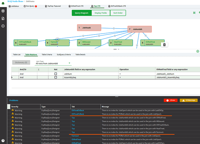

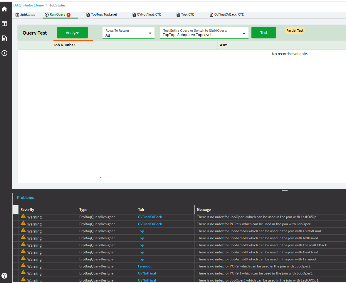

You can also analyze your query to get some good suggestions.

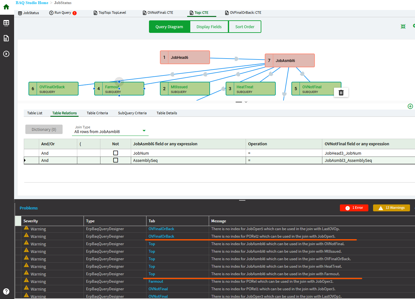

For example, these missing index warnings are those missing Company in the join criteria:
If you add company to the subquery then to the relationsions (join) the warning should go away and perf is better.
Regarding CTEs. Switching from inner-subquery to a CTE is pretty straight forward. In the Subqueries slider, simply drop down and choose CTE
Now the important part when it comes to CTEs is the order top to bottom. CTEs used in other CTEs must come first. In your example. Top is used in TopStatus and AsmStatus so Top must come before those.
If you’re familiar with MSAccess, think of CTEs as TEMP tables (like when you first run a Make Table Query and then use the temp table in subsequent queries). Sometimes you can get away with subqueries ( query in a query in a query, etc) But other times those inner queries are running so may times you take a perf hit so it pays to run a make table then join to the table instead. CTE is like the temp table. Especially beneficial for aggregates, calcs, and conditionals like CASE (IIF), COALESE (IsNull) - do them once then use them many times in subsequent queries.
Hope that helps. I know I learned a thing or two.

I didn’t realize the time was staring me in the face the whole time! I often run the sub queries and consider performance one at a time. I didn’t even notice the time in there! Thank you. And Thank you for all the other details. This is very helpful!
FWIW, I have no idea if it’s db exec time or server round trip. I did notice that it drops significantly after a few execs which is common for SQL once it gets a plan and caches your data. When it drops to the bottom limit after a few execs, you’re no longer getting an accurature reading as if the query was run without cache so you prolly need to go get a coffee and come back to it.

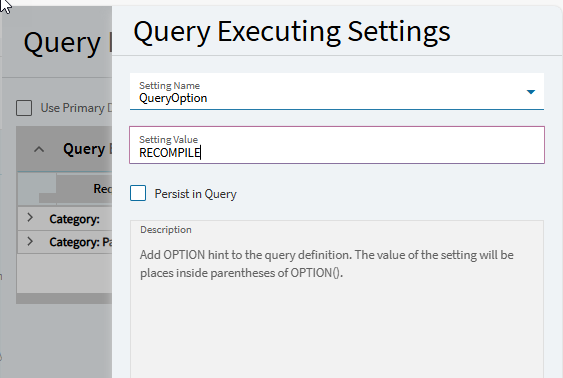

PS- the normal way to ensure cold cache in sql server is OPTION RECOMPILE. There’s a hints setting in the BAQ designer which may work for this. Haven’t tried it.
You can use recompile to flush the cache with option(recompile) in Execution Settings.
Previous thread about it: Some of our Epicor users experience extreme slow downs on loading a BAQ through a customization but when using a different user ID on the same computer, its fast! - #3 by josecgomez
youre a mind reader. thanks for that.
