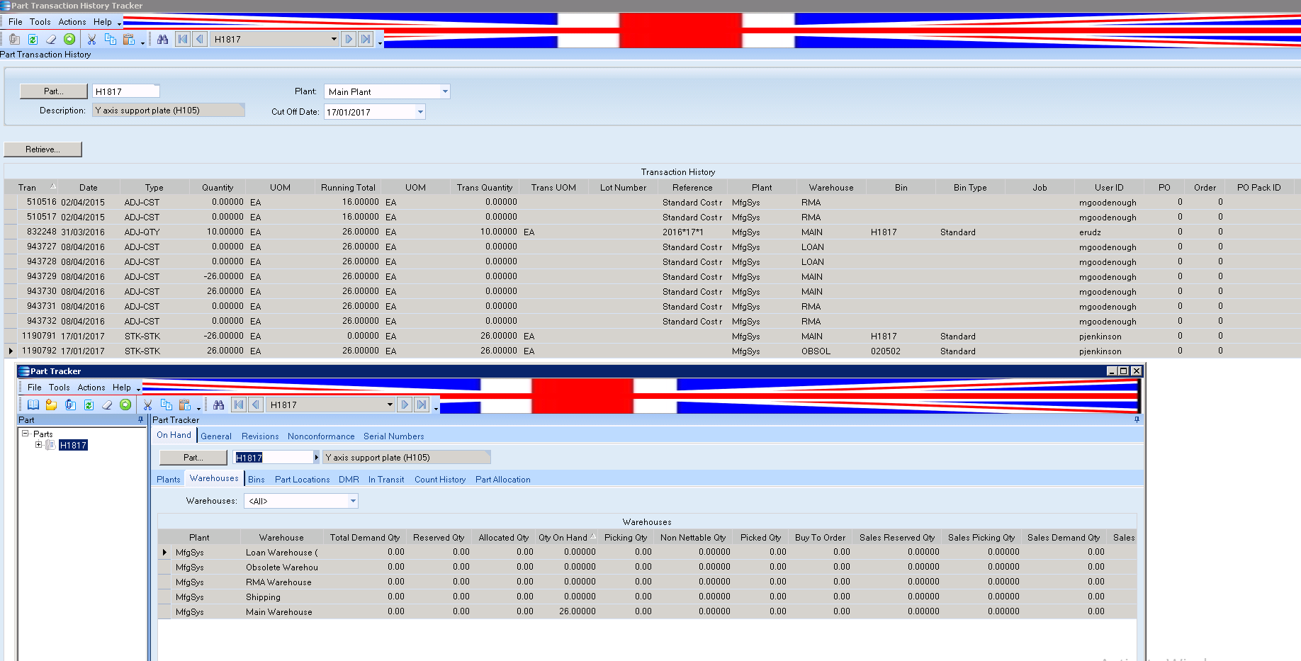

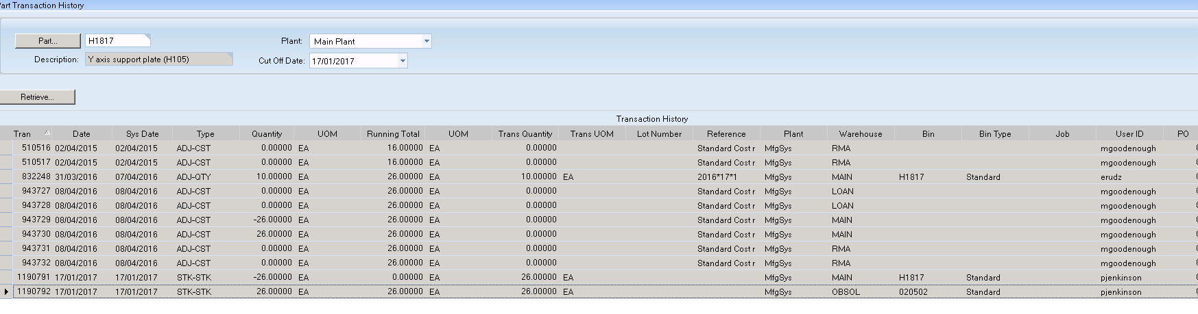

Something odd has just happened, my colleague did an inventory transfer moving 26 x part number H1817 from the Main warehouse to Obsolete warehouse.
You can see the transaction in the part transaction history tracker and it has a TranID…however, the part tracker numbers haven’t updated and the 26 are still in Main??
I ran conversion 6480, but it hasn’t fixed it.

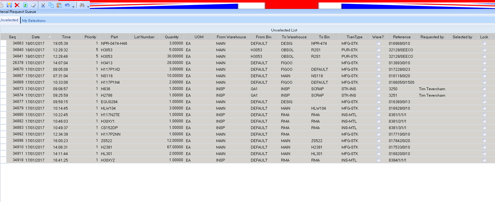

Have you verified on the Advanced Material Management under Material Request Q if the transaction is there?
Dear Dora,
the transactions are not in the Material Request Queue…
I also looked in Material Queue Manager…they weren’t in there either.

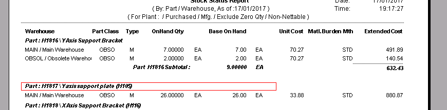

What does running the Stock Status Report say?
Hi,
The stock status says the 26 are still in main.

This is the 26 in the stock status report, still in the Main Warehouse.

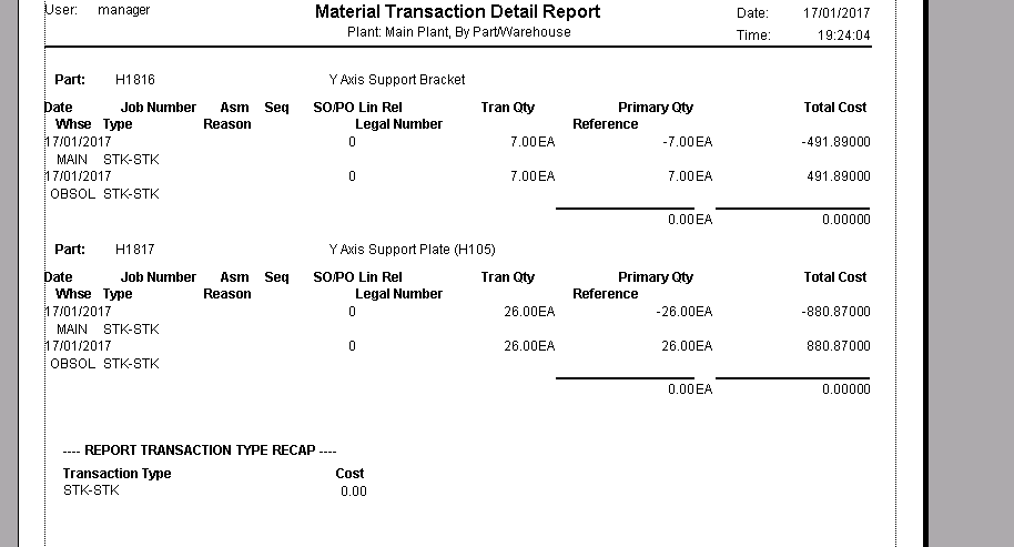

Just ran the “Material transaction detail report” in Inventory Management/Reports …and as you can see the transactions are there.

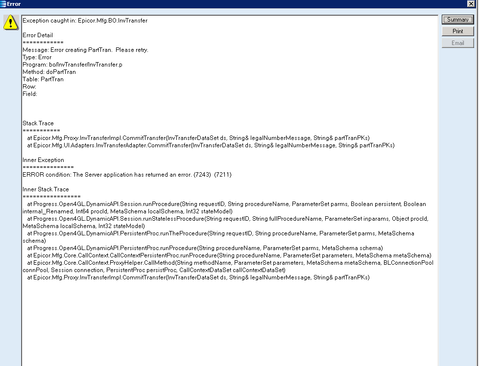

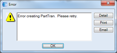

When my colleage tried to do the transaction…he said he go this error message:
Here is the detail behind the error:
