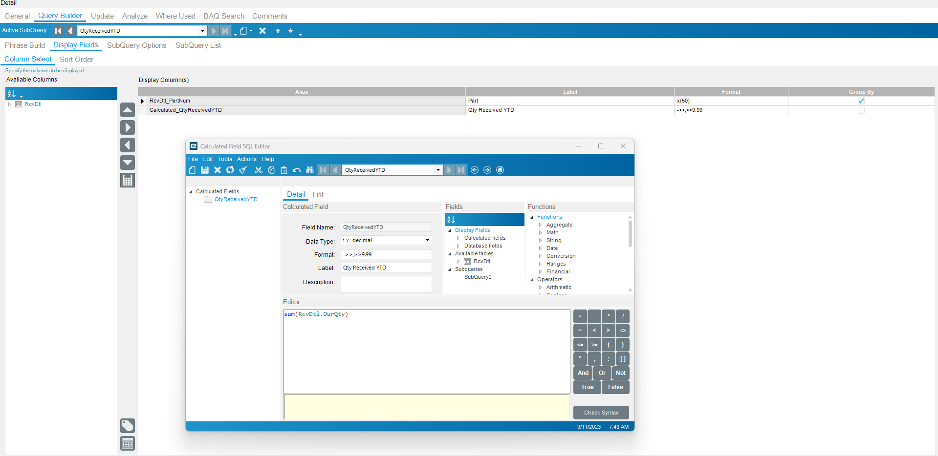

Using only RcvDtl here is the subquery that when added has caused the top level query to break.
Here’s the table criteria I have on RcvDtl.

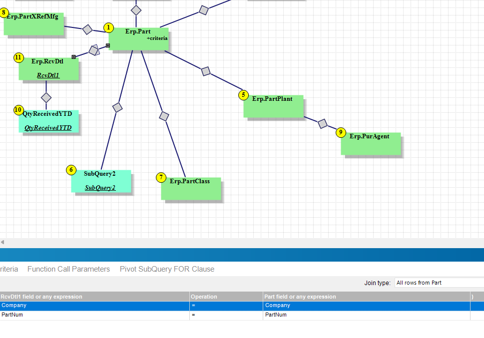

Can you post a screenshot of the joins to the subquery?
Joining to rcvdtl from the subquery just by the part number.

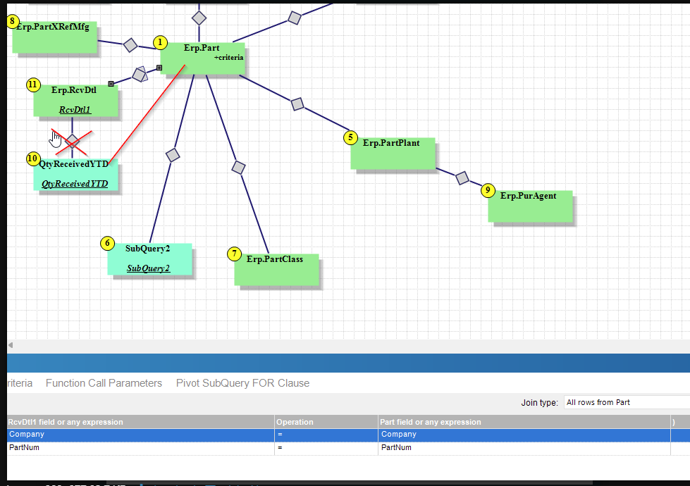

Why are you joining to rcvdtl and then to your subquery? Get rid of that and join from part to your subquery.
I need another field from RcvDtl. I originally had the subquery joined to part and then RcvDtl joined to the subquery but switched those around to try and join on company. The subquery does not have Company in it.
If you need rcvdtl separately then directly join from part to the subquery. Chaining those together you are running the sum individually for each and every rcvdtl record that is returned. And always make sure you include company in the subquery and ALWAYS join on company. It doesn’t matter if you only have one company.
It doesn’t appear to have made it any faster. Thank you for taking the time to try and help me speed it up!

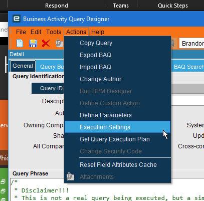

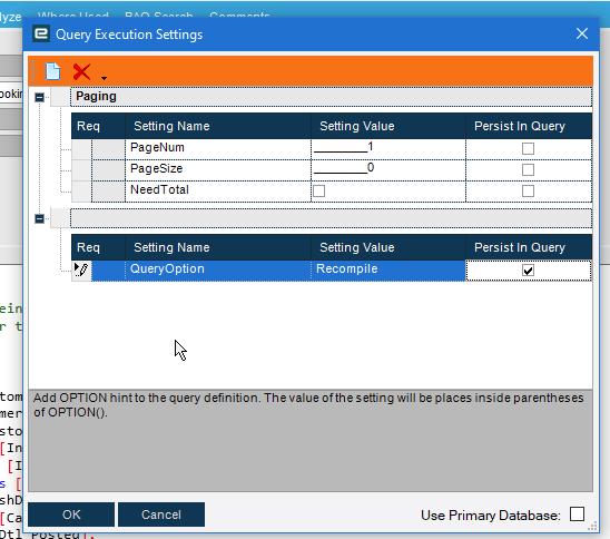

What version are you on @jott ? If you are on a new version, then you can try adding option(recompile) and see if that kicks it into gear.
I’ll politely semi-disagree with that. Always try joining on company. However, sometimes (even usually) that also tanks query performance for inscrutable reasons. So also try joining without. Go with whichever is faster.
I think I’m still pretty much in the same place query wise.
@Banderson, I tried the recompile and after 5 or so minutes I’d get an error and 0 results. I removed it from the execution settings and am back to getting 800 results in 4 minutes. I’m on 2023.1.10 by the way.
