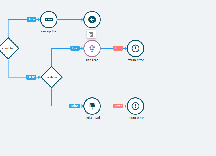

I don’t dislike the edge client in the least bit! I didn’t know it talked to scales, is this accessible to us? in App Studio layer?
Nevermind I see USB Read and Serial Read #Nice!!
