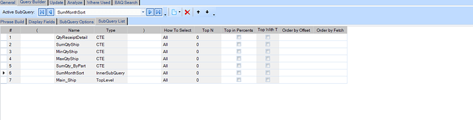

this is my BAQ to get the number of Receipts by month
DMS_GetPOReceipt_SumPart.baq (59.3 KB)

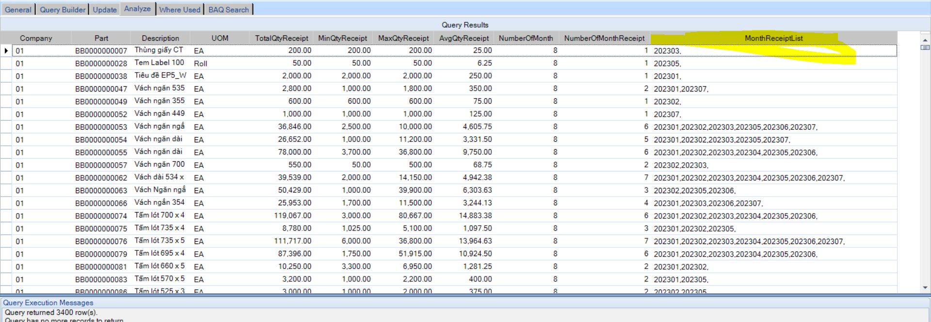

It looks like your duplicates are coming in from the first CTE, QtyRecepitDetail. If the same part is received on more than one packing slip on the same year/month, you get a duplicate. Put the packing slip number and pack line number into your report to see the source of the duplicates. Then decide how you want it to deal with those duplicates.

because I do sum by part The monthReceiptList column is for me to check which Part has 2 consecutive months without inventory when the code is on customization
