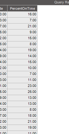

The SUM(CountEarly.Calculated_CountEarly) displays data just fine:
