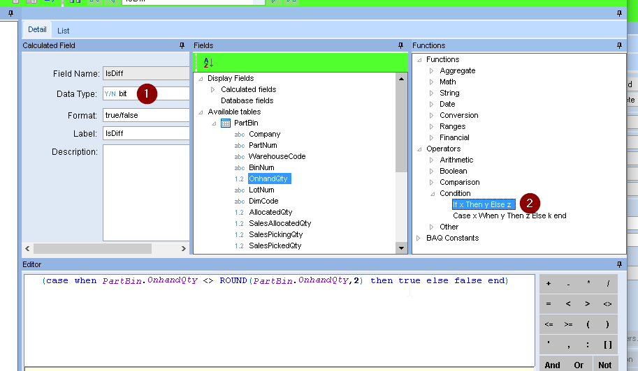

two things …
  1. The data type shouldn’t be Decimal
  2. use Operators -> If x Then y Else z in the Functions pane, for the If statement (which won’t be implemented as an if statement)
EDIT
calc field should be
(case when PartBin.OnhandQty <> ROUND(PartBin.OnhandQty,2) then 1 else 0 end)
(using 1 and 0, instead of true and fals)

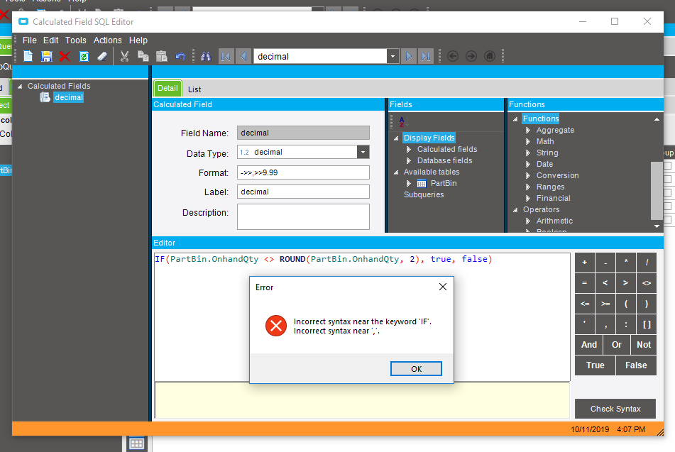

@Kimberley you are using IF and not IIF (2 I’s.) and it looks like your type should be Boolean not decimal if you are returning true/false, otherwise use decimal and return 1, 0.

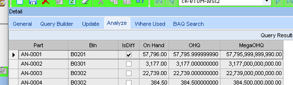

In the pict below,
  • I tweaked (via SQL) part AN-0001 to be 57795.999999990 (well past the 2 digits we’re setup for). It normally shows as 57,796.00 on all forms(“On Hand” in the BAQ below).
  • OHQ is that same value but with the format set to ->>,>>9.999999999
  • MegaOHQ is a formula of OnhandQty * 1000000, with the column format just 2 decimal places
Hope this helps

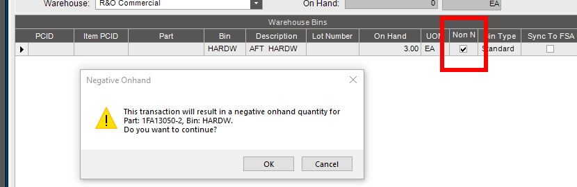

I think Calvin is on to something with the non-nettable. The grayed-out on-hand quantity says zero in Kimberley’s screenshot (for the warehouse quantity), even though the (only) bin on-hand quantity is 3. I know the warning is about the bin, but somehow it’s not believing the 3 OH.
This is what made me question it.
Since Non-Nettable bins are intended to be excluded from QOH, maybe there is a bug with respect to this. The QOH in that Bin is 3, but the available QOH is 0. So subtracting 3 (in the Bin) from the 0(“On Hand”) could be causing the issue.
@Kimberley try transferring those 3 from that bin to a nettable bin. Then see if
  1. Bin HARDW still shows a qty. Note: it shouldn’t appear at all. If it does but shows zero, then theres some far out decimal
  2. You can issue the 3 from the newly selected bin
