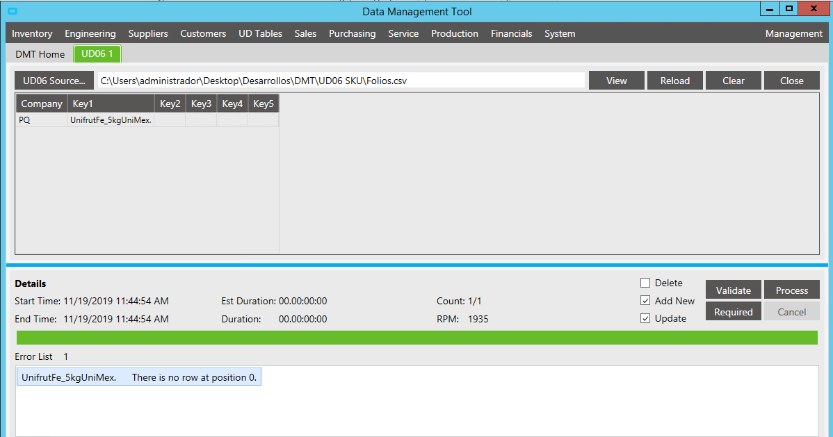

DMT Error UD06 There is no row at position 0
I receive this error when I try to add new records to table UD06, I did it with more columns and with the required fields.

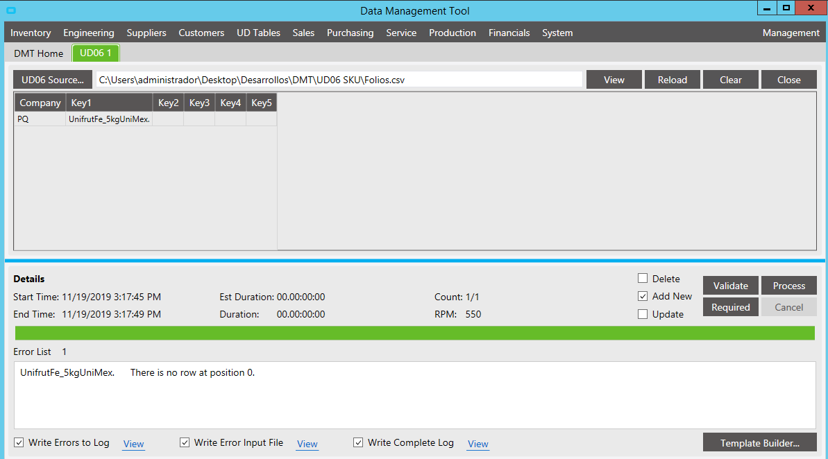

Try it without the “Update” box checked.
I tried it, but gave me the same error message
Can you try with a single sheet XLS file? Maybe there’s an issue with Unicode?
Yes, I deleted all the sheets, empty rows and columns and saved my file like .xls and .csv and I changed the Key1 value, also I tried with values in the Key columns.
I found what was happening, I forgot to deactivate a BPM restriction. :grimacing:
Thank you very much for your answers.
