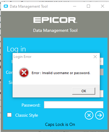

One of my users is getting an Invalid Username and password for the DMT. Never had this issue before. Where would this be stemming from?
Have them double check the Environment dropdown selection. Occasionally my changes to “GOLDEN”
They can’t even get there. They double click and the error comes up.

drag that error box away so you can see the environment and SSO settings

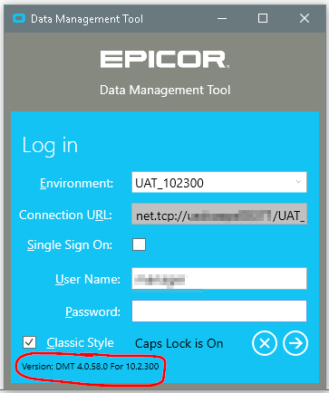

Your dialog box appears to be missing the version info…
Yeah, I noticed that. I realized the license file wasn’t in the folder. So took care of that. Npw they are getting that the server is busy and to check the Event logs. There event logs are saying:
