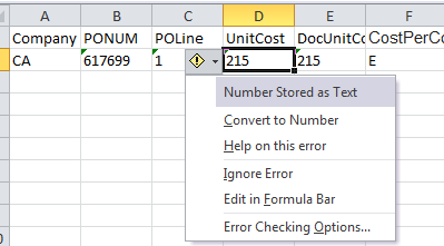

Just looked at your excel file, and while I don’t think it’s an issue, I did notice that many of the fields that hold a number, are actually stored as text.
Open that file in excel and change columns B-E and G-H to General (or Number)
