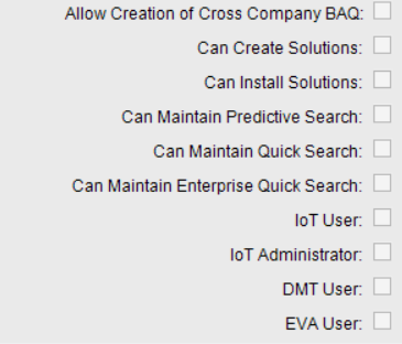

1.) DMT.exe (add the associated .dll) are distributed with EVERY client install. DMT is no longer a separate program. Your license key will enable DMT for your companies and the .lic file is no longer required.
2.) User Account Security Maintenance can enable DMT by user:
