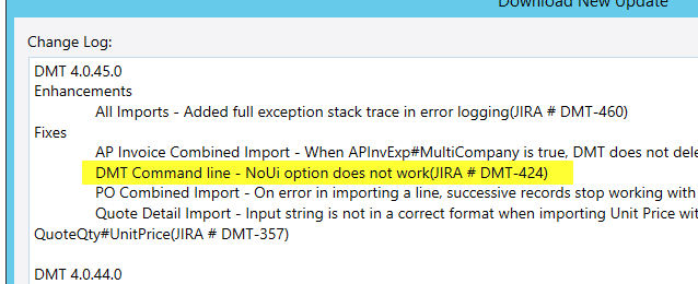

FYI for anyone interested, I found out this is a bug in the current version of DMT, with a fix slated for the .45 patch release. You can see Epicor Problem# PRB0212767 for any info.
I see version 4.0.45.0 was released today.
