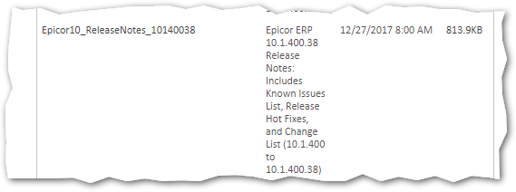

It would be nice if Epicor included revision history with the DMT downloads like the updates for the product do …
The DMT folder only shows …
And the zip files those links point to only have…

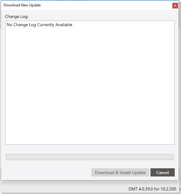

I think the most frustrating part about DMT is that there are no release notes. I have no idea the scope of what I’m getting into when I upgrade it.

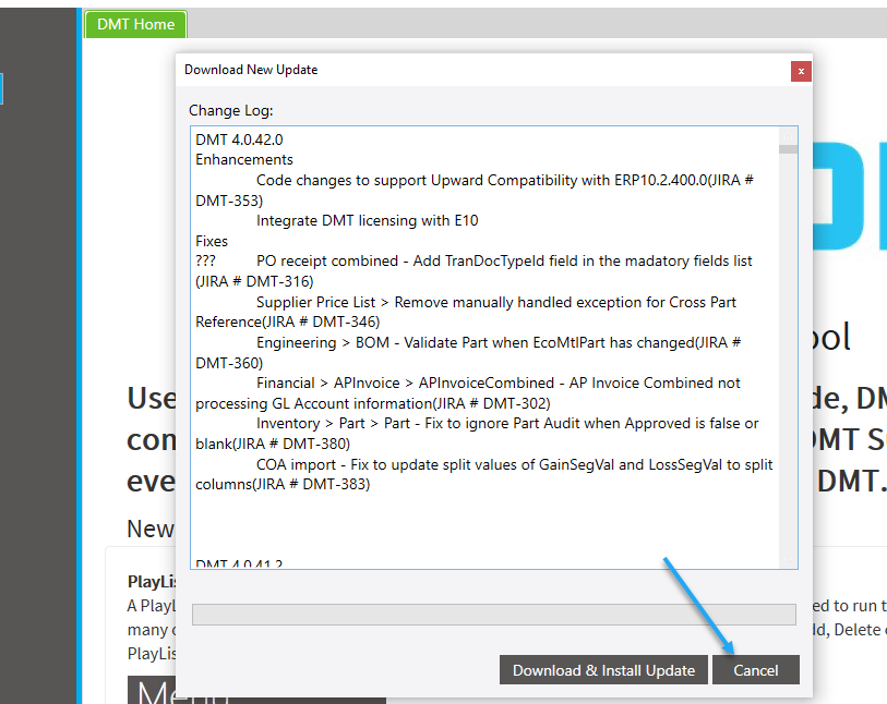

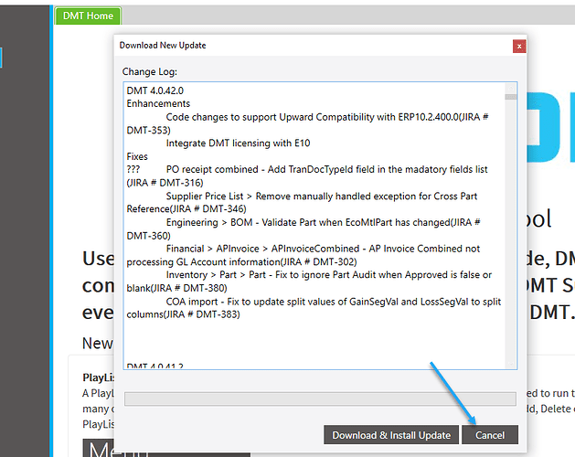

Have you tried just clicking on the check for updates having the update dialog popup and clicking cancel if you don’t want to update? :slight_smile:
By the way there is a new version as of the 08/04/2019…Might also be worth mentioning that you can setup alerts on the downloads page to tell you when things change for DMT.

You’re correct! I had not seen that. But as you can see, things don’t always work as advertised. :slight_smile:
Still, it would be nice to see this like everything else, in a separate doc.
