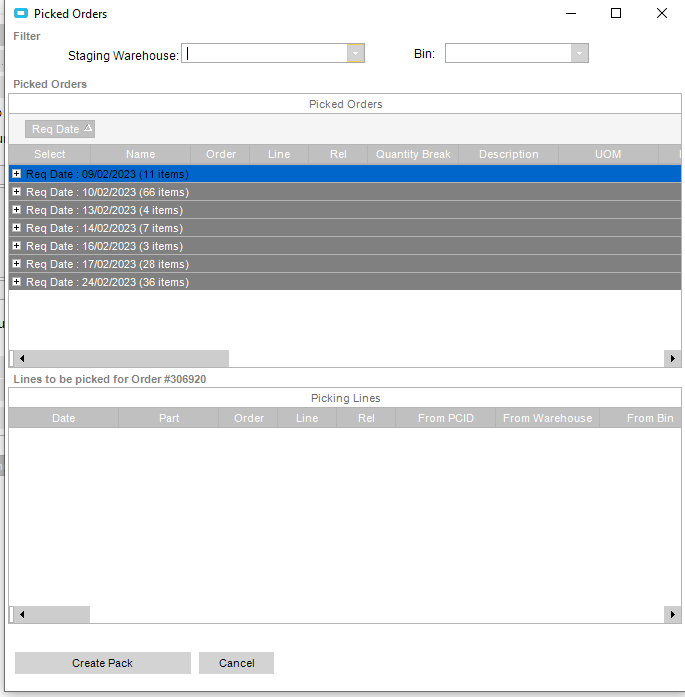

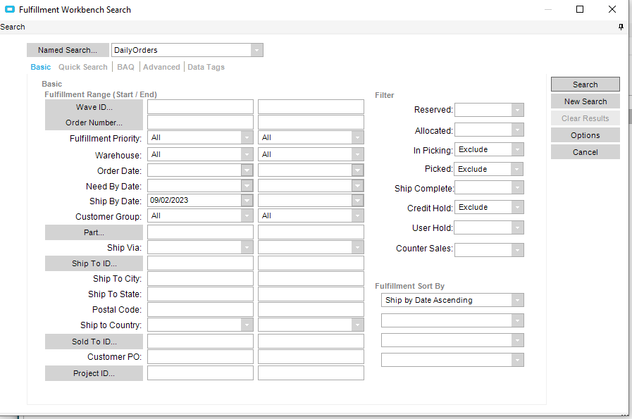

As fulfillment workbench is picking/packing orders and some companies may pack orders 1-2 weeks in advance prior to shipment I don’t think the DNS method will prevent this. However, sounds like more internal training or perhaps a BPM on Customer Shipment Entry. We have our Picked Orders grouped by Req Date & Customer, generally we stick to our Ship By Dates or communicate with departments to get dates amended if they’ll accept earlier shipments.

Another interesting note is it gets allocated/reserved in the order it appears in the screen. So, if you sort by one date then that will affect which releases get allocated/reserved first.

I don’t know what the default sort by date is - I was talking about the filters. I’m not sure we sort it any differently than it shows up by default.
