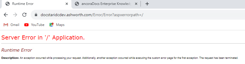

@gpayne or anyone else - have you tried to get to 9.3 yet?
I’ve tried 4 times now on a VM (keep reverting my snapshot) and I get the same result. I’ve double checked the Certificates, addresses, services, log-on accounts, etc. I’m a bit stumped…
