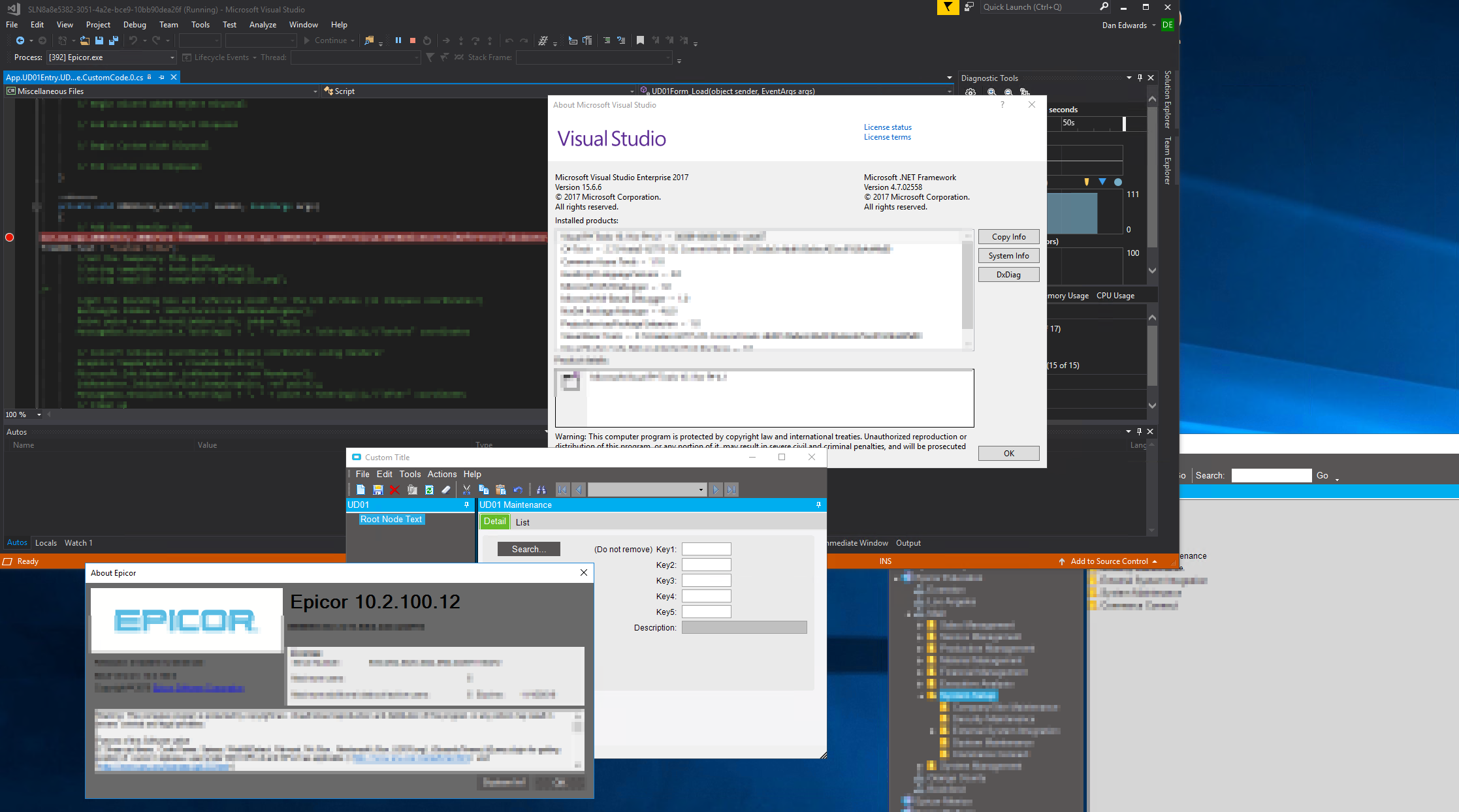

Here is VS 2017 working with 10.2.100 as I step through a debug. I wonder what “supported” means. Could be perhaps some feature is not working, etc. I have this installed in at least 3 VMs for debugging and have not ran into an issue yet.

I’m running VS 2017 professional. A couple releases behind yours, 15.6.4
We’re on 10.2.100.14 though I expect that wouldn’t make a difference.
Is there any chance you could provide a list of installed features? Wondering if I missed a component on install.
edit: Pretty sure “supported” just means they have a document with that version listed. Nobody I talked to could give me much beyond “it’s not listed as supported in our KB”
