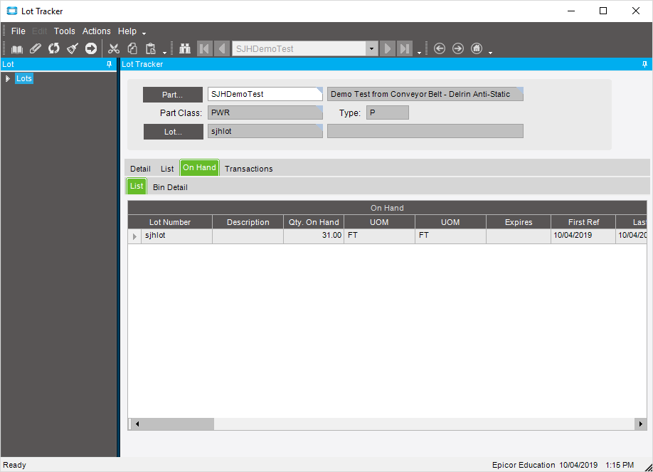

Just noticed in the Lot tracker that if you quantity adjust in quantities other than the IUM the Quantity on hand in the Lot tracker shows incorrectly. I’m wondering is anyone else has seen this?
Here’s an example from the demo system, replicated in both 10.1.600 and 10.2.300
Hello @Hally,
I have seen this before, and typically a Refresh Part Quantities and Allocations will resolve this.
