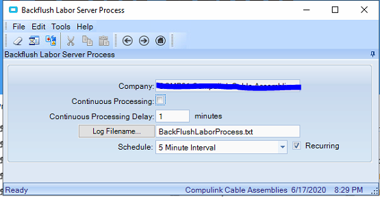

To get backflush to happen a quantity needs to be reported on the operation. To do that you would make a Laborhed/LaborDtl combined entry with a labor quantity. There is a TE Labor Combined section and a TE Labor Combined.csv template that you can use to find what is needed. From there some trial and error. Also make sure you have the Backflush labor Server Process running on a timed schedule of 5 minutes and not on startup.

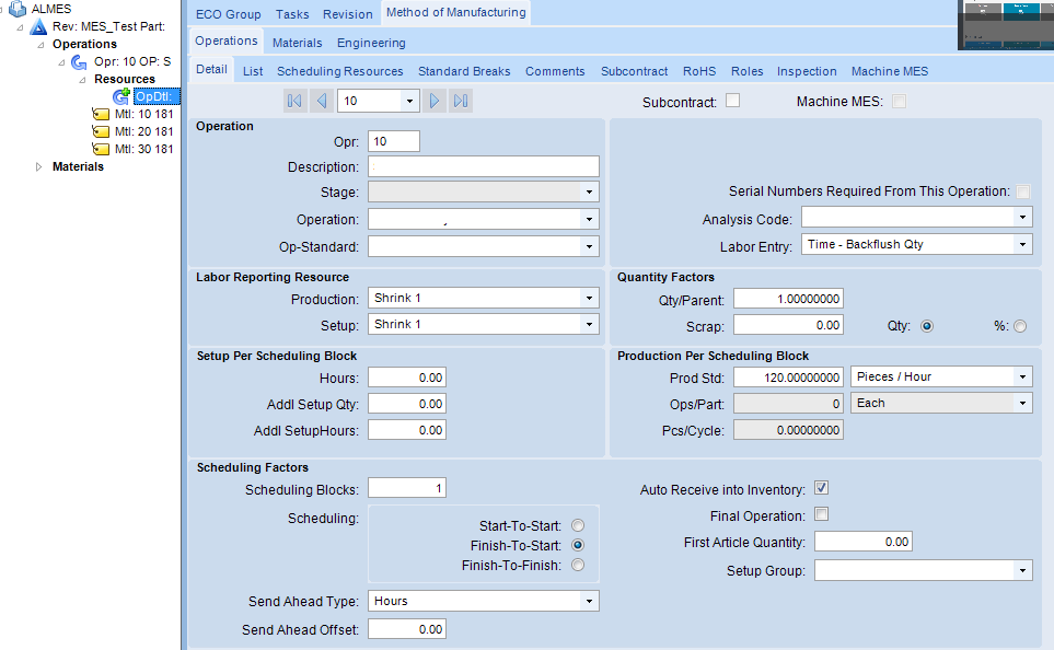

Also, I created a test revision and wanted to make sure this is set up correctly.

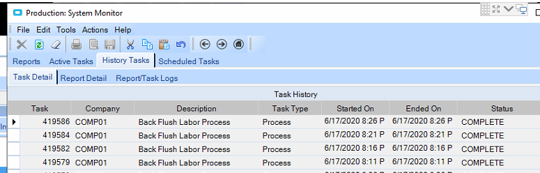

Edit: Found the process to run, I’ve got it showing in System Monitor as scheduled. . . Just trying to see if it actually runs and backflushes the parts.

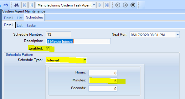

Are the materials related operations set to 10? If it not recurring I think it will only fire if you stop and start the task agent.
In system agent make a schedule for 5 minutes.
Submit backflush labor process and assign to the 5 minute schedule, recurring.
You will see it run or fail in the system monitor.
I think the labor needs to be Time and Quantity to trigger the backflush. Backflush would be operations that would be hit by the backflush process

I ensured in the test revision the material parts were associated with Opr 10, and changed the labor to Time and Qty.

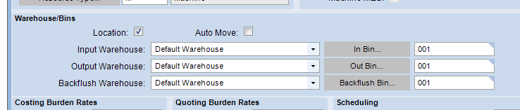

I would turn off auto receive since you know that is working and look at the labor. do you have a labor entry made that shows in job tracker? Does it have a quantity? if so what is the resource group on that labor detail? Does the RG have a backflush location and bin? Does that bin have a quantity on hand?

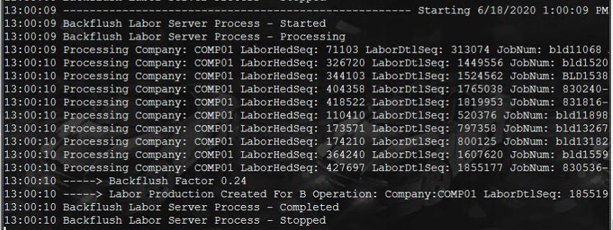

I am trying to find where me backflush log gets written to see if it has any info that would help you.
Here is what i see in my log.
I set up default bins to backflush the material,

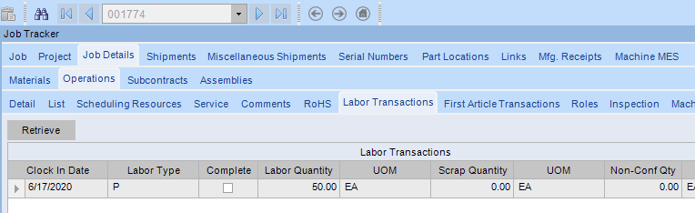

I see a Labor Transaction as well in the Job Tracker.
Yes, the LaborDetail does have a quantity and resource group.
