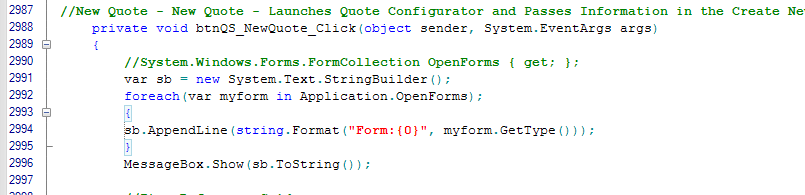

I think this will help but I am getting this error.
Error: CS0103 - line 2994 (10931) - The name ‘myform’ does not exist in the current context
Strange. I just wrote some similar code and got similar results (see below). I wonder if maybe you are referencing the variable outside of the loop… Try replacing lines 2991-2996 with the code below

Try removing the semicolon on line 2992.
And try removing the semi-colon on 2992.
Edit: @andrew.johnson got there first!
Oh I see that now… definitely the semicolon is the issue!
