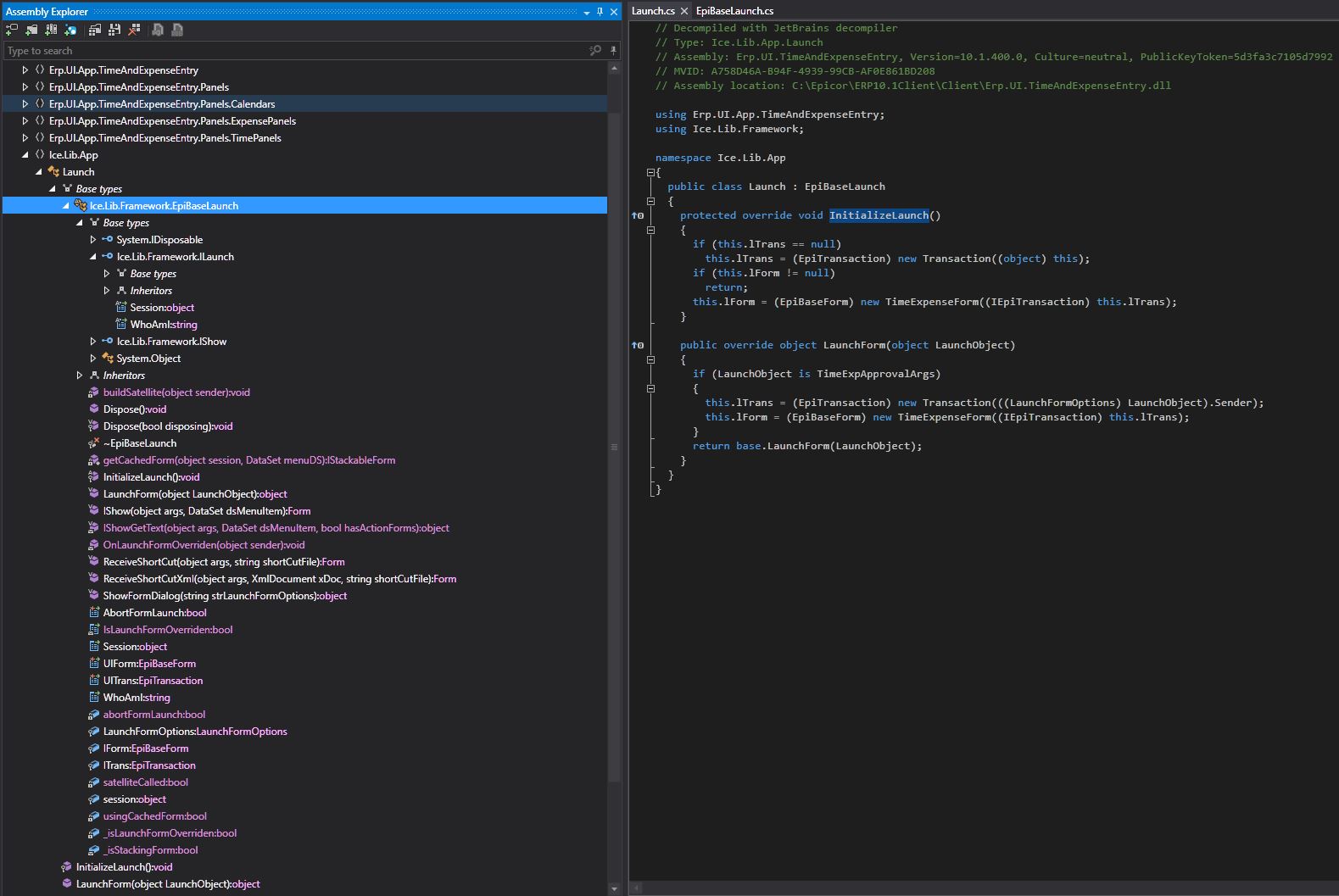

Yup @Chris_Conn that is usually the way to get a form to load a record with its key value available and perform and auto search. - although for the sake of completeness with your code snippet, and generically applying it to all Epicor forms!! ;): - it doesn’t have to be a hashtable and may be a tilda delimited list or a simple string value, something like lfo.ValueIn = “100~1” or just lfo.ValueIn=“100”, depending on the form that is being loaded. Worst comes to worst - you can decompile the UI assembly and look at the launch class.
Hey @Chris_Conn & @kjavid, thanks for taking the time to reply. Would you be able to give me a little more detail? I’m not really a programmer, so some of this went right over my head.
Right now I have this code with launches T&E.
private void btnLaunchTimeEntry_Click(object sender, System.EventArgs args)
		ProcessCaller.LaunchForm(this.oTrans, "UDTimEnt");
I decompiled the Epr.UI.App.TimeAndExpenseEntry.dll, but I got lost in what to look for.

Have a look at this in the disassembly:
private void FormLoadFromApprovalEntry()
That’s OK @nhutchins as you can see in the “public override object LaunchForm(etc)” method is being passed an object of type TimeExpApprovalArgs. If you click in that type you will be able to see the fields available to set in your launch form options.

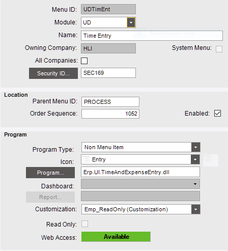

Are you sure you have a form named UDTimEnt? You should be able to find it in your Menu Maintenance.
Yup, and if I use the commented out field below (without the lfo), it launches (but without an empID).

Be sure to change your menu name back to UDTimEnt too

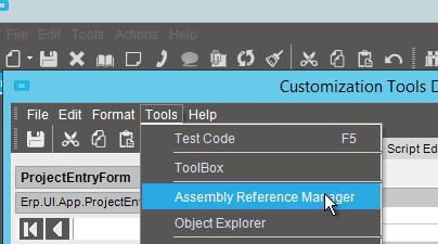

What do you mean by import? When I am in the script Editor, it says " Error: CS0234 - line 19 (19) - The type or namespace name ‘Core’ does not exist in the namespace ‘Ice’ (are you missing an assembly reference?)"
Awesome, Thank you.
I have added that and now I am getting a new error, This is not for the TandE that was discussed, but I am using a Dashboard that I created. I get the below error.
Error: CS0103 - line 60 (92) - The name ‘oTrans’ does not exist in the current context
Error: CS0103 - line 71 (103) - The name ‘oTrans’ does not exist in the current context
