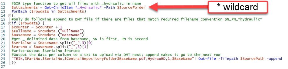

Yes, I did receive the same ‘iterative function/for loop’ answer from their support but was a little bit more than what I was expecting so I might just head the Powershell route. I’ll probably just use a = Get-ChildItem “C:\Reports\” in the directory with Powershell. Can Powershell do the wildcard * for dynamic file names?
Yep you can use wildcards. Here’s an example I use to pick up filenames for making Epicor attachments / create the DMT file

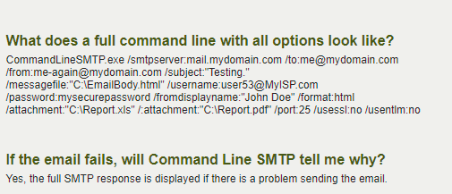

For multiple attachment, use the /attachment:
switch multiple times.
Like:
Commandlinesmtp.exe /smtpserver:smtp.verizon.net /to:me@example.net /from:billgates@ms.com /subject:"testing" /message:"CommandLineSMTP" /username:bgates@ms.com /password:"Ih8j0bs" /port:465 /usessl:yes /attachment:"C:\temp\b1.txt" /attachment:"C:\temp\b2.txt"
So in a batch file you’d have to first build a variable that contained all the matching files found.
setlocal enabledelayedexpansion
set al=
FOR /r %%f IN (b*.txt) DO set al=!al! /attachment:%%f
echo %al%
then add %al% in place of the
/attachment` switch and file name
Commandlinesmtp.exe /smtpserver:smtp. .... /usessl:yes %al%
