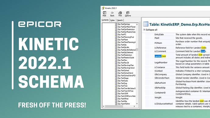

Nice! That would help everyone. Generating the documentation is easy, once MS_Description data is filled in.
Not sure if these scripts are better than yours
but feel free to use them. I had some SQL Genius a few years ago write these for me. Basically extracting the details from ZData and putting into MS_Description.Then I use any 3rd party tool to generate chm or html.
