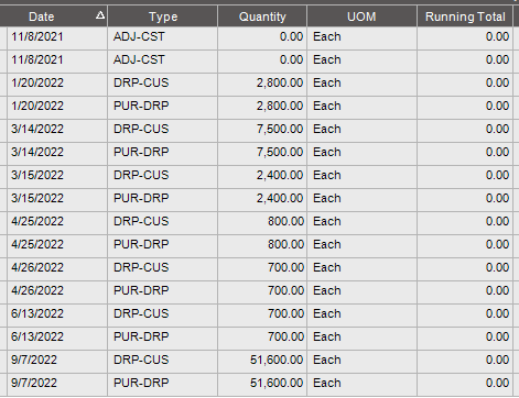

the first thing I would do is check the Part Transaction History. Try matching the transactions related to this PO.
Just spitballing… I’d check: tran dates and UOMs. Make sure TranType is correct and that none actually ended up in inventory. Look for receipts that were reversed and then re-received.
Sadly, all good there…
The PO num matches on the expected trans?

Thought this thread might hold the answer, but I don’t see any reversals of the drop shipment in my Part Tran Hist Tracker.
Using the Part Tran History? Doesn’t that have a default cutoff date of today?
What if a transaction was done with a bad date (a future date) and then someone corrected it by unreceiving it (also with that future date). That wouldn’t show with the default cutoff.
