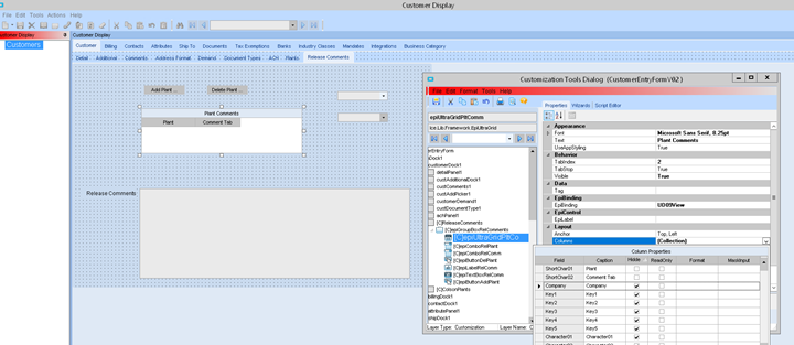

I have included a screenshot from the Customization for your reference related to your latest reply as I understand it. So I went in and changed the code to be “UD09View.ShortChar01”, I received the same error but with the new field name.
That’s strange. It could be that the grid is not yet set up when InitializeCustomCode runs. It might be worth trying the same thing in the EpiNotification event for your UD09View instead.
