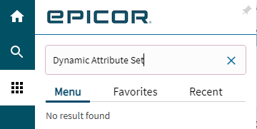

In 2022.2.5, Dynamic Attribute Set menu was not available for us in the Epicor menu. It was only available in DMT.

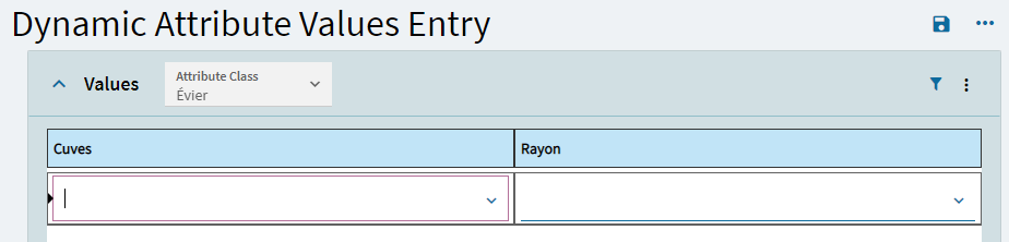

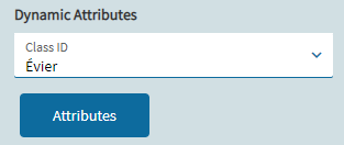

What feels wrong to me is that we do have the DynamicAttributes module. We can use the Epicor UI to assign Class & Attributes to a Part. Epicor generates a Dynamic Attribute Set from this, but it requires another module (AUM) to maintain these generated Sets.
The Dynamic Attribute Values Entry grid does 2 things in the background :
  1. It creates a Dynamic Attribute Set (or reuse if it already exists);
  2. It assigns the Attribute Set to the Part.
#1 can no longer be done in DMT without the AUM module. This leaves us with no way to quickly import Part Attributes.
