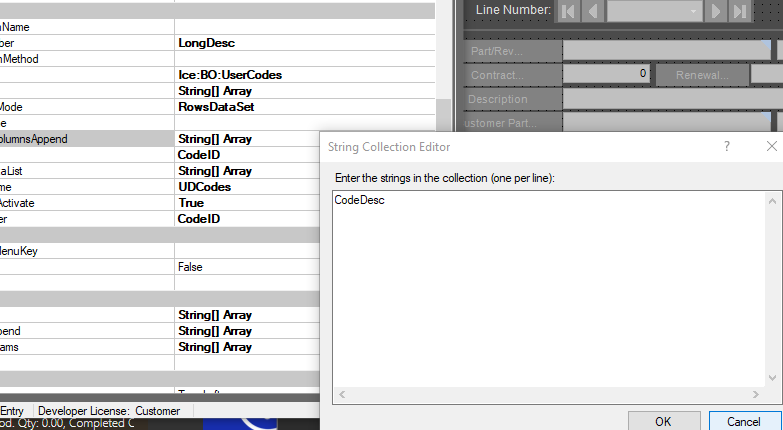

Add CodeDesc to the EpiHiddenColumnsAppend property so that it is included in the returned data :slight_smile:
http://jcg.pictures/gdgfajhi4sEja.png
It’s in there.
Also add it to the EpiColumns Property…
Both LineDesc and CodeDesc are in the EpiColumns property.

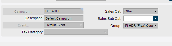

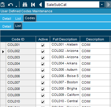

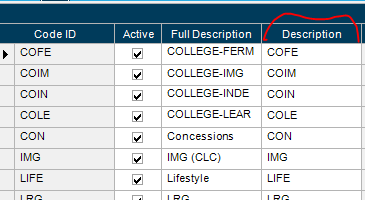

Right now I have the Sales Sub Cat user codes like this - image (description = SalesCat)
Sales Cat user codes -

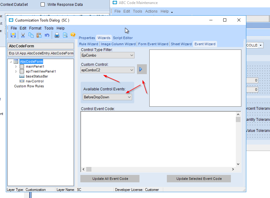

This time use the Wizards -> Event Wizard-> Before DropDown Event on your SubCat Combo
the following 3 lines of code will add a dynamic filter to the SubCatCombo based on the SelectedValue of the SalesCombo. Note I used the EpiDataView CAllContextBPMData you’ll have to change it to whatever DataView you are binding your combo to.
private void epiComboC2_BeforeDropDown(object sender, System.ComponentModel.CancelEventArgs args)
		EpiDataView edv = oTrans.Factory("CallContextBpmData");
		epiComboC2.Rows.ColumnFilters["CodeDesc"].FilterConditions.Clear();
		epiComboC2.Rows.ColumnFilters["CodeDesc"].FilterConditions.Add(Infragistics.Win.UltraWinGrid.FilterComparisionOperator.Contains,(string)edv.dataView[edv.Row]["Character01"]);

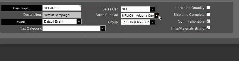

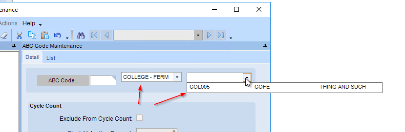

Here’s a preview of how I set it up: (Order Entry Screen)

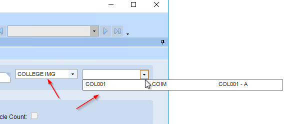

How can I set the epiCombo to act like the default combos, so that if an order line is closed it will be read only? Example pic -
That’s how it is right now, it’s not a huge deal - but it’d be less confusing if it acted the same way as the other fields.
