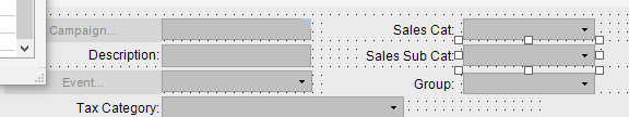

So basically I have a UD field on the OrderDtl table for Sales Sub Categories. We’re having issues writing reports/trackers that capture all the data about the orders (such as royalty information)… So this is what the Sales Sub Category will be for going forward. (We need to use the OrderDtl.SalesSubCatID_c field so it’s easier to report on it in the future) Now I’d like this combobox to act like the dynamic lists in Product Configurators.
So as an example if someone selected the Sales Category “MLB” I would like only the “MLB - ****” Sub Categories to show. Has anyone done this or something similar?

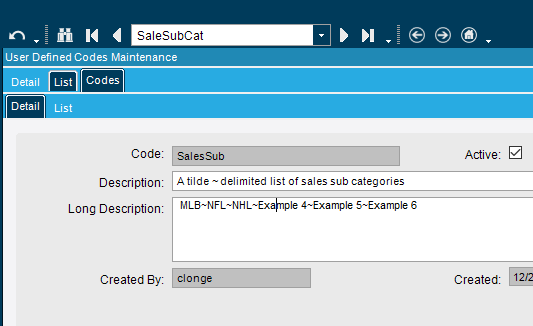

So I got the epiCombo to pull in from the UD Code’s LongDesc field -
BUT I can’t figure out how to get it in list form. I figured I could make the list using tilde’s, but it doesn’t seem to recognize that … Any ideas?

I understand that, but I already posted a pic of this setup without using any code…
I just can’t seem to get the LongDesc stuff to be in a list format by using one UD Code - I guess if it’s not possible I’ll have to go with creating codes for all the sub categories like Ben said.

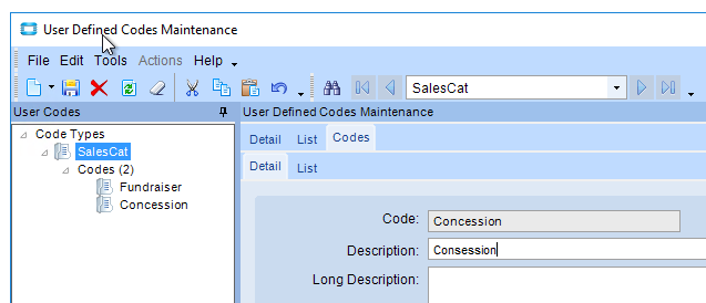

I have the default Sales Cat combo box pulling off of the UD code SalesCat as shown here:
image image
Now I’m trying to get the custom combo box to filter off that info but I can’t seem to get the correct syntax/order down.
So here’s my Sales Category combo info:
And
Here’s the Sales Sub Category Custom combo info:
Within the epiFiltersAppend I have “CodeDesc = ‘?[SalesCatId, 0]’” but I’m getting the error that this isn’t a valid column. If I change it to LongDesc I don’t get any errors but then the combo box comes up as blank.
For your post (#15) you show that I need my Descriptions to matchup with the actual sales codes, but I wanted to say that I’m not using FullDescription for that, I’m using just the Description field.
See -
What am I doing wrong here?
In your filter condition, check the capitilisation – should be SalesCatID not SalesCatId. Also, if that doesn’t work then try OrderDtl.SalesCatID
