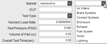

This kind of worked -
But it doesn’t act the way I thought it was… I’m going to have to play around with that part of it

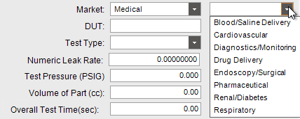

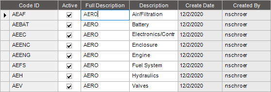

LoL it will cause we are using the Contains Operator so anything that field contains will match

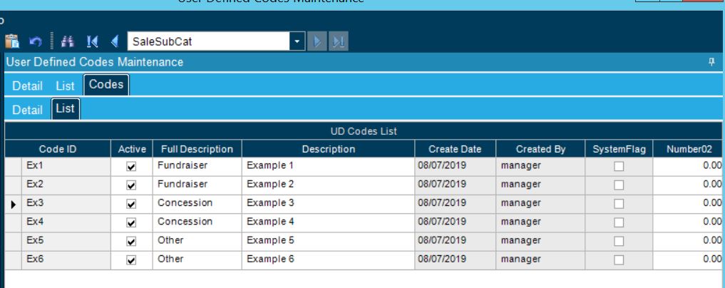

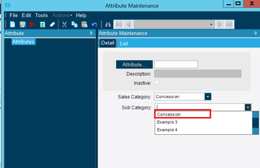

Dear josecgomez, I have followed the same steps as mentioned above posts but one more value is coming extra in sub category marked in attached last screen shot
can you please suggest, how to resolve this isuue?

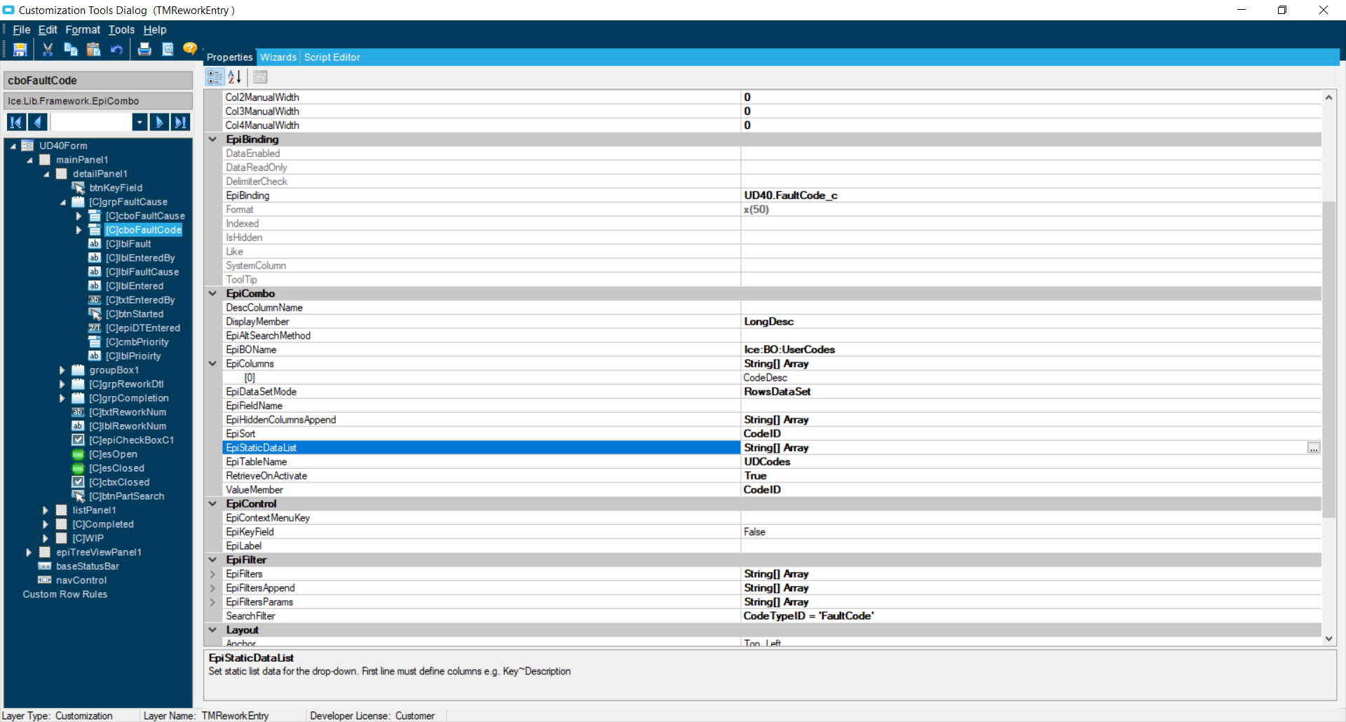

@Caleb323 your original idea of populating an EpiUltraCombo from the tilde delimited string in UserCodes can work as follows:
using System.Collections.Generic;
using System.Linq;
string SpecialLabelPrinterList = "";
// skipping over the code that pulls a tilde delimited string from UserCodes
private void CmbPrinter_BeforeDropDown(object sender, System.ComponentModel.CancelEventArgs args)
List<string> printerList = SpecialLabelPrinterList.Split('~').ToList();
this.CmbPrinter.DataSource = printerList;

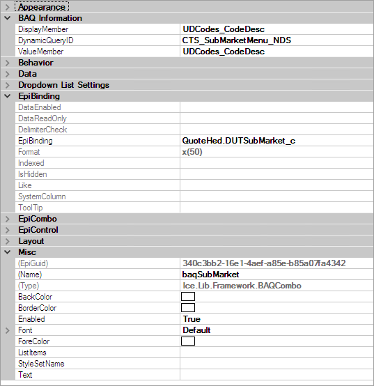

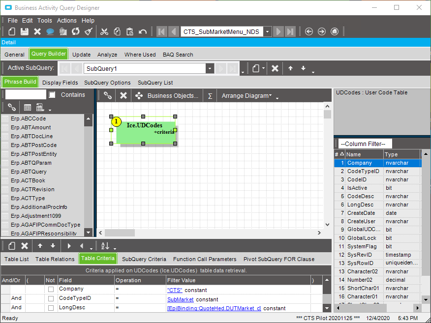

Since it looks like this topic is still relatively fresh, I will give my input. The solution I found was pretty easy and required a little less coding than some of the solutions above. I gave most of them a try before settling with the solution outlined below, so thank you all for your contributions.
Overview:
For my example, we have a UD field named DUTMarket_c and a related UD field named DUTSubMarket_c that we wanted to change our options dynamically with the selection of the Market. Instead of using an epiCombo Box, and adding C# code, I used a BAQCombo Box. This allowed me to write a BAQ querying our UDCodes and then using another field as a variable to dynamically change the list as the value of another field changed.

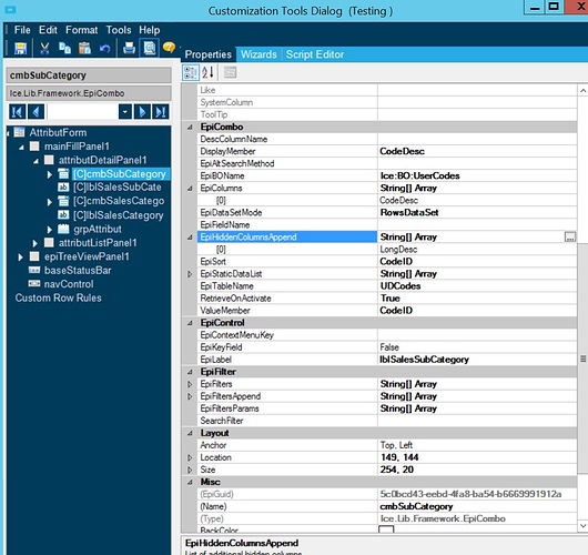

I’m getting this error when using @josecgomez method.
System.Data.SqlClient.SqlException (0x80131904): Invalid column name 'CodeDesc'.

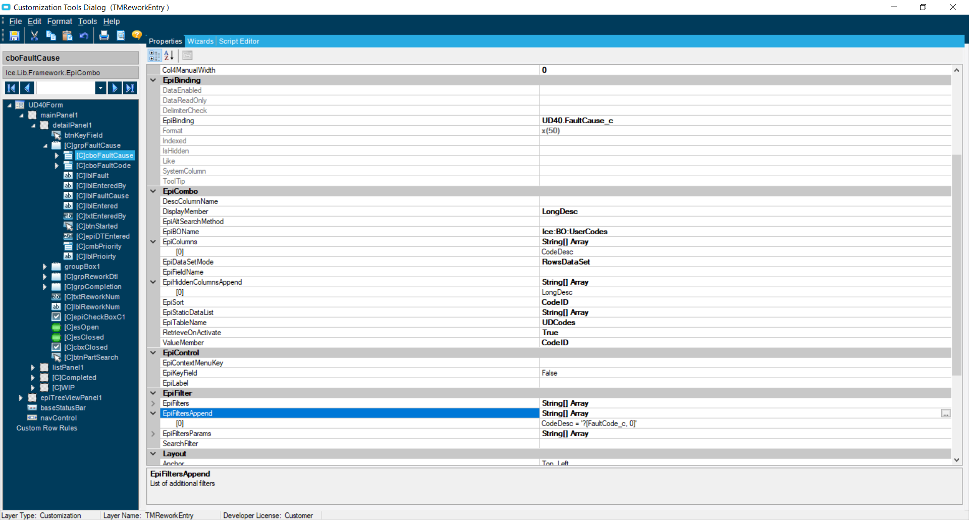

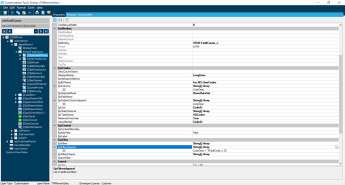

private void cboFaultCause_BeforeDropDown(object sender, System.ComponentModel.CancelEventArgs args)
EpiDataView edv = oTrans.Factory("UD40");
cboFaultCause.Rows.ColumnFilters["CodeDesc"].FilterConditions.Clear();
cboFaultCause.Rows.ColumnFilters["CodeDesc"].FilterConditions.Add(Infragistics.Win.UltraWinGrid.FilterComparisionOperator.Contains,(string)edv.dataView[edv.Row]["FaultCode_c"]);

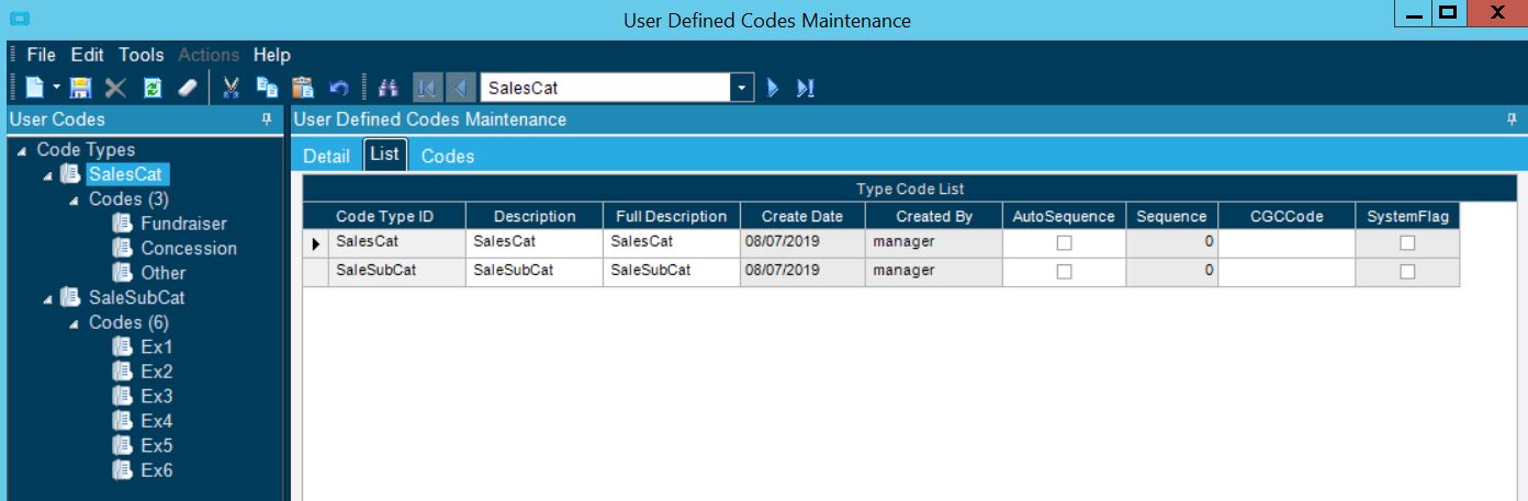

This works for me:
In your EpiCombo cmbSubCategory > SeachFilter : CodeTypeID = ‘SalesSubCat’.
