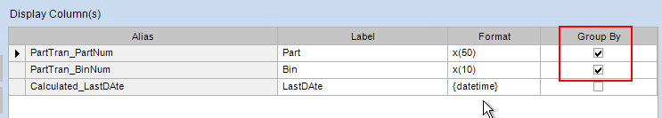

I used the group by display columns
Any calculated field that uses aggregates (like MAX(), MIN(), COUNT(), SUM(), etc…) must have it’s GroupBy box unchecked.
If you need to group by that calculated field, you need to add another subquery layer.
Just to add on to what Calvin says, when you use grouping you have 2 rules:
Any field that is aggregated (sum, count, avg, etc) must be set to NOT GroupBy
All other fields MUST be set to GroupBy

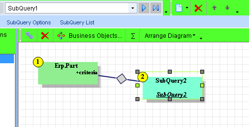

You may have created subqueries, but you need to add them to the top level query
Here is a simple BAQ that retruns the MAX(PartTran.TranDate) for each part and TranType
SubQuery1 (obviously it was completed after Subquery2 was made)
Subquery2 (it could have more tables and joins)

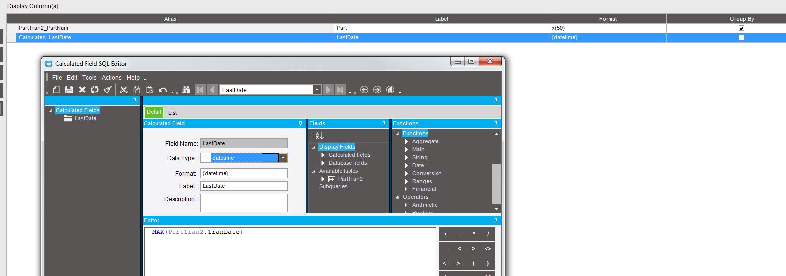

Subquery2 display fields. Note that all but the calculated field are “Group By”.
The expression for the calculated field is MAX(PartTran.TranDate)
Subquery1’s table relations

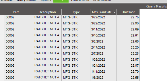

How do I get only the cost associated the max tran date? more details…
This time I want the the cost associated with the last transaction date pulled from the subquery from above. As soon as I bring in the cost field it adds the grouping by each different cost. I did a max cost along with the max trandate which brings in a single record for the part, but the max cost is associated with a previous date.
