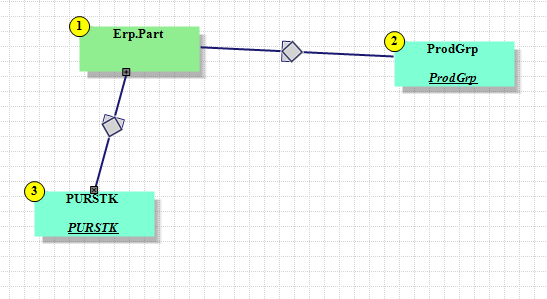

I started with Part and added a sub-query for Purchase transaction using PartTran and filtering for PUR-STK. I linked the two queries and made a calculated filed in the top query for max(PURSTK.PartTran_TranDate).
This worked and I have all the parts listed with the last Purchased date listed next to purchased parts. As soon as I add another filed from my sub-query my BAQ blows up with multiple rows. It seems any iteration of adding another field blows up the BAQ.
Here’s my current Phrase build, I haven’t added the second sub-query for MFG part yet.
And here’s my query phrase:

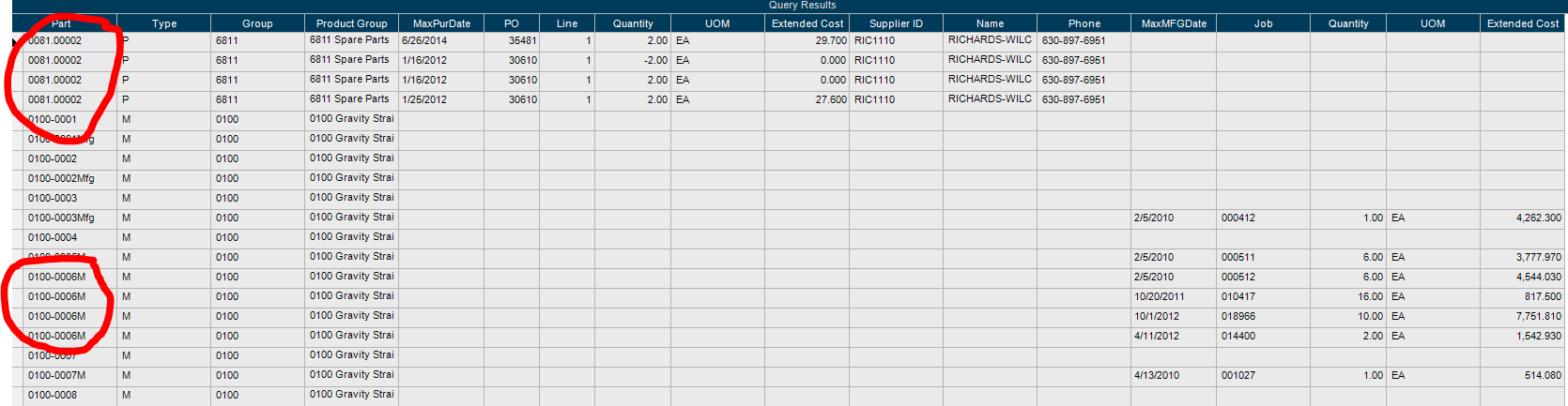

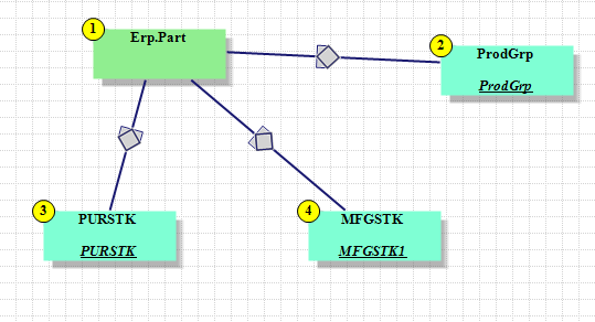

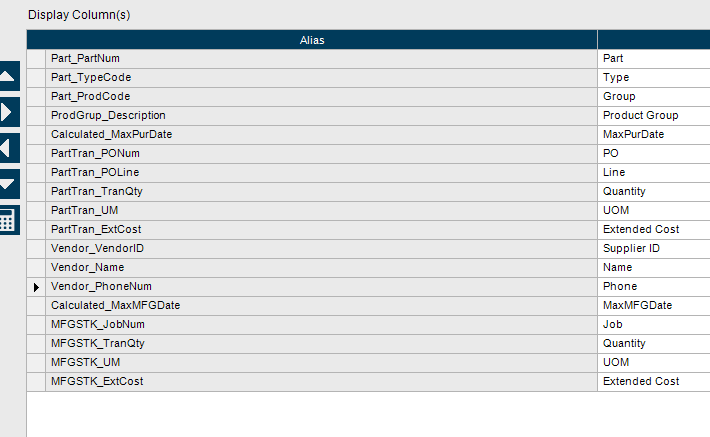

Thanks. So for S&G I threw the entire BAQ together as I think it should go. It looks like my subqueries are returning every tran date instead of the last tran date.
Here’s my query:
This time I did my calculated field for MAX trandate on the subqueries instead of the top level query:
And my Query Phrase

My results, a few of the 183,000 lines, 3X the number of parts.
The circled items are duplicates.

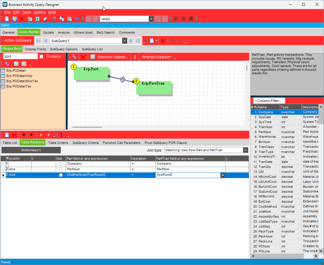

Also look into Sub-Selects
I usually end up doing something like this, if I need more columns.
More Info:
Windowed functions are the way! So much easier to write and reason about and live with than group by.
