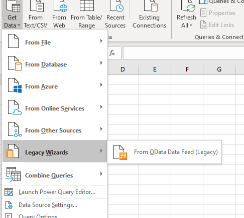

I thought that Excel 365 no longer worked with v1 and you must use the Legacy Plugin in Excel. Thats where v2 and ODATA 4 came in they worked with the new connector.
v2 is for 10.2.400 - Since you mentioned it on top I assumed you were on 10.2.400.
v1 does not work with the New Adapter to my understanding or atleast doesnt for me anymore since a Office 365 Update I get a 404 - but Legacy is fine.
I had to use v2 and also in addition add my server to the Trusted Root Certificates.

From MS I had to use Legacy for old v1
3 The new OData connector available in Power BI and Excel 2016 reads the service metadata and caches it regardless of the HTTP header specifying it should not be cached. I have a case where new entity sets are added dynamically and metadata does change. The user has to clear the cache after each data retrieval otherwise only the entity sets available during the first call are available.
The workaround is to use the legacy data importer which I hope MS will continue to support in future Excel releases.

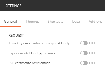

By default, Postman will ignore SSL verification. Check your settings to see if that is enabled.

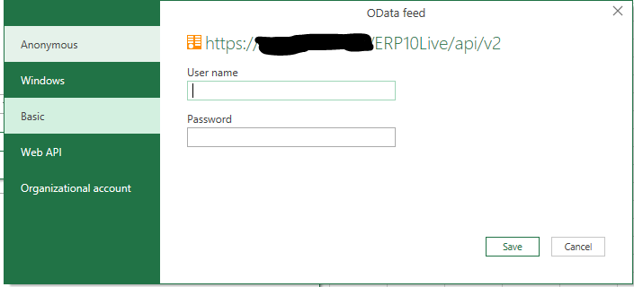

As per Olga’s suggestion above I have a little look in the IIS log. And can see a 302 redirection to a login page, but I am not receiving a dialogue in Excel to enter credentials.
A little digging around in Excel and I found “Data Source Settings” in the “New Query” menu on the “Data” ribbon.
Within there were some of the URIs I had been trying and sure enough the cache credentials were set to ‘Anonymous’. Changing them to known epicor logons and eureka! data is returned for both v1 and v2 REST calls.

On the Excel side, for the query I edited the credentials after the initial request threw an error.
