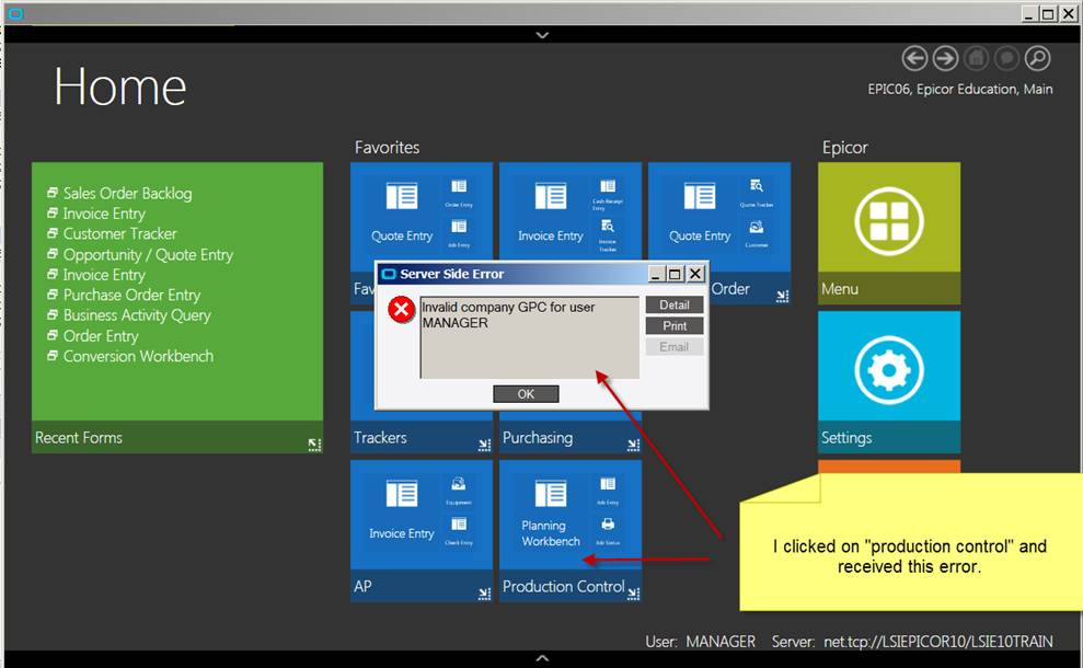

I installed a copy of the Training DB and it mostly works but I get this when clicking on the Planning Workbench.
When I try to go into Job Status Maintenance I get this error.
Can anyone tell me what this is ?
Thanks,
Neil

Looks like there is a bad favorite record in the database. Let me review my internal database, and I’ll provide a SQL script fix shortly.
I’ll submit a bug request against this (for the issue launching Job Status Maintenance). In the meantime, please do the following.
update ice.favitems
set appserverurl=’’
where appserverurl <> ‘’
For the issue with Planning Workbench, please do the following:
EDIT: I am not sure if the issue is with how the favorite was created, or if the manager user really should have access to the GPC company–either way, I’ll submit a bug for this issue as well.
Hi Nathan,
When I try to pull down the company drop down box, GPC is not there to choose.
Thanks,
Neil
Something is a bit wonky here–I’ll dig into this more internally.

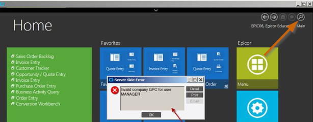

Below is the process I use whenever I am trying to launch a menu item when I don’t know where it really is in the main menu tree.
NOTE: Below the name is the path in the main menu tree to manually launch it if needed.
NOTE 2: If you right-click on the item, the bottom tray auto-opens and on the far right of the tray are some new icons that appear. One of them (the star) adds it to your favorites, the one with a home adds it to your home page. If this is an item that you plan on launching frequently, you may want to add it to one of those areas.
