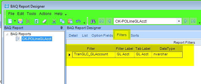

Here’s an example of a BAQ Report (happens to be SSRS, not CR), with just one Filter

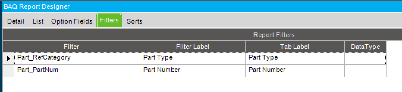

I see two filters:
These both correspond to the “Filter2” field.

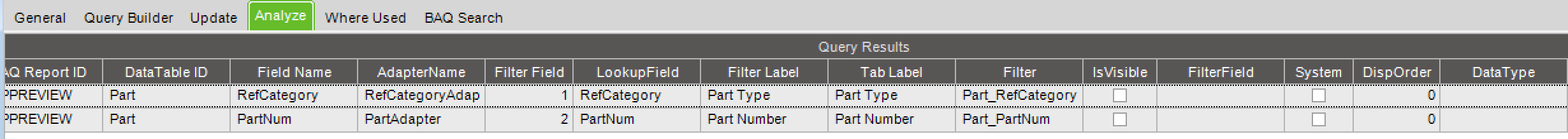

What does a query of the table BAQRptFilter yield? EDIT: what are the Seq values for those two filters?

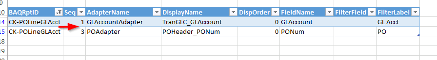

BTW - it looks like the filter numbers don’t get re-sequenced if you delete an earlier one. Here’s a shot of query results after removing the 2nd filter of a BAQ Report .
The sequence numbers are 1 (Part_RefCategory) and 2 (Part_PartNum). Do I read this to mean that the first one should be Filter1 and not combined with Part_PartNum?
That would be my guess.
