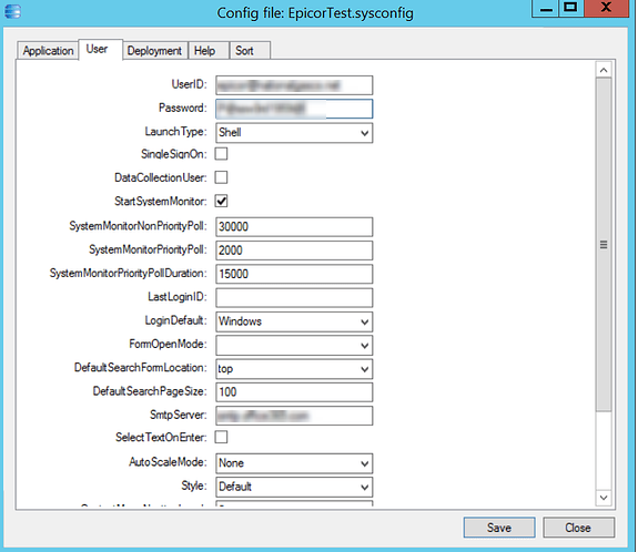

After that, I opened the sysconfig file and enter the User Name, Password & SMTP server name (refer to attached screen)
But " Failure sending mail" message is coming.
I redacted your username, password, and server host please make sure not to include that info in screenshots for your own safety
I dont think you can set a username and password on the sysconfig. You’ll have to have a relay @jgiese.wci @EarlGrei do you remember?
PS: @Hari_Dutt I really hope that’s not your password… I recommend changing it… STAT.
Depending on Epicor version you can set username and password directly but for overall ease in dealing with office 365 as a whole a relay is life.

ok, regardless you can’t set that in the sysconfig you’ll have to have a relay setup. Or use what everyone else suggested and send email server side.
How to set email settings in sysconfig file & what are those settings ?
As I stated you cannot set username and password in the sysconfig. You will have to setup a relay.
Please let me know how to set up a relay?
This is like wayyyyyyyyyyyyyyyyyyyy beyond the scope friend. I think @EarlGrei has a post about it on here, but if you don’t know what it is or how to set it up it may be time to get someone to help (outside this forum) this is not an Epicor question is general IT and requires quite a bit of experience and know how.
