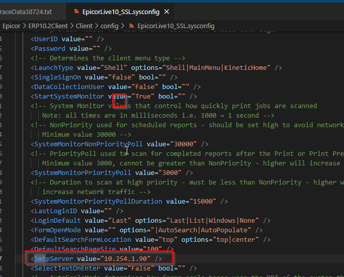

Epicor has a built in Email handler on the customization you can use
EmailArgs args = new EmailArgs();
args.ToAddress = "test@epiusers.com";
args.Subject = "Please format your code for the love of God!";
args.MessageBody = "Simply put ``` before and after your code it will make EVERYONE happier";
args.FromAddress = "EVERYONE@e10help.com";
EmailHandler.SendMail(args);
It reads the SMTP information from your SysConfig File
Good to know. Thanks Jose!
Thanks Jose. I didn’t know that.
