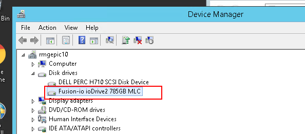

HI Jason,
I think we are already using Fusio IO
For the DB and such… I just think its something specific to this DB. I’ll keep plugging at it though

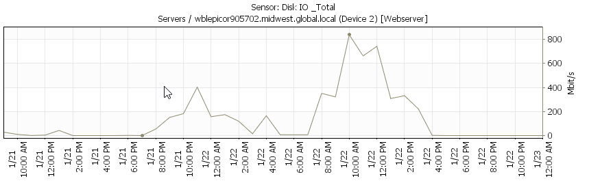

I would track the actual throughput on the drives just to be sure its being used properly. Ours hits close to 800Mbit/s on the 9to10 part. I will check the tables sizes next go around to see what is maybe different between the two.
What are you using to measure the throughput?
We use PRTG Discover the 3 Paessler PRTG monitoring solutions , there is a free trial or free version you can download and setup. You will want to run it on a separate server. It’s been very helpful helping us track down performance problems, especially on the E10 upgrade and SAN performance testing.

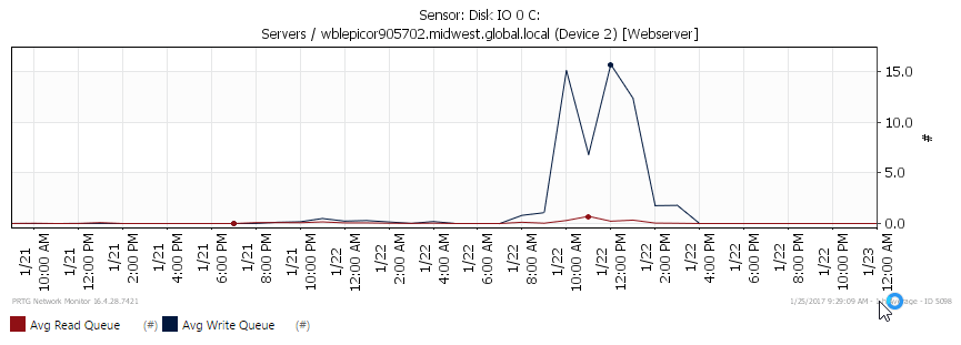

An average disk queue length greater than 2 is telling you that you have an I/O problem.

The queue length is interesting. We are seeing pretty high spikes during the conversion, this server is dedicated for this process and is running a Fusion IO card. We must have something holding us back here not sure what it would be.
I’m pretty sure we are setting the initial size, but I will double check that.
I bet those two humps are from log file or database file growth.
