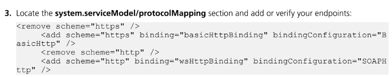

Here is what the guide tells me I need(seems to be commented out):
This protocolMapping copied from the guide fails with a runtime error:
<protocolMapping>
<remove scheme="https" />
	<add scheme="https" binding="basicHttpBinding" bindingConfiguration="BasicHttp" />
<remove scheme="http" />
	<add scheme="http" binding="wsHttpBinding" bindingConfiguration="SOAPHttp" />
</protocolMapping>
