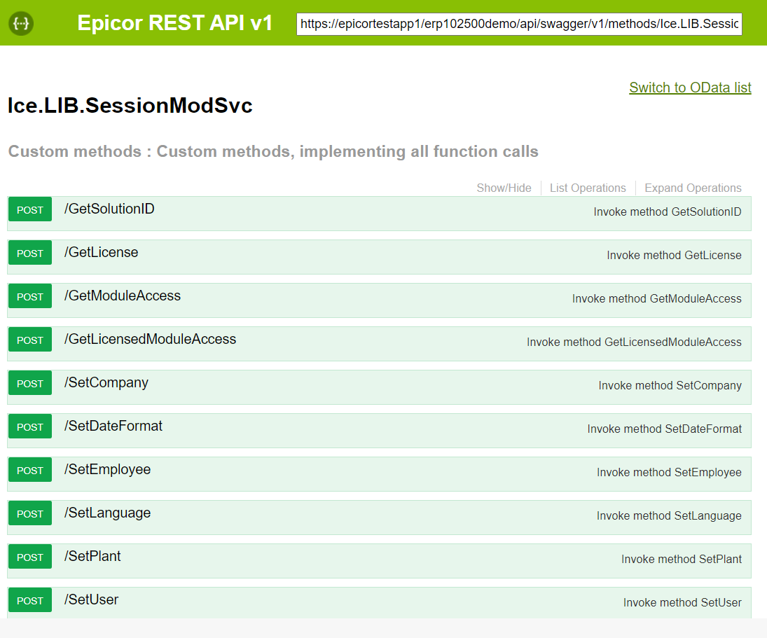

The REST services are self documenting, just follow the basic documentation, they will guide you to the API page, and then the documentation for each method call is directly in the page.

Yes Sir. If you go to https://epicweb.epicor.com/products/epicor-erp-10/documentation, browse to your base version (10.2.600, 10.2.500, etc.), go to Technical Reference folder then you will find the v1 and v2 REST guides there.
