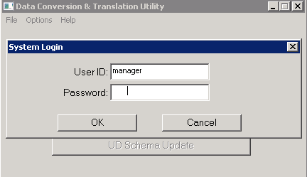

  1. Download the attached magic_readonly_record.bpm to your server that has the Admin Tools shortcut.
  2. Rename file to magic_readonly_record.r.
  3. Launch your Admin Tools.
  4. Log in with a security manager user.
  5. Click on Run Progress Program.
  6. Click the Magnifying glass button, and browse to the magci_readonly_record.r file.
  7. Click Open.
  8. Click Ok.
  9. Click Ok to the “Program succeeded.” message.
  10. Close the Admin Tools program.
  11. Log in and open any record you wish or try to create any new record you wish.
  12. Congrats, your database is now in read-only mode!
