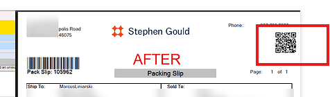

What is the QR code used for at the top of your pack slip?
It is actually used by your idea @utaylor, that’s how we scan it back into Epicor, an idea we borrowed from your presentation at insights. #SuchAnEasyWin #Genious
It contains DocTypID to trigger the right ECM workflow (and the Pack ID)

Wasn’t this your presentation at Insights? Maybe I’m mis-remembering. Yes it works well they scan / email it to ECM and it goes fromm there.

As far as adoption, we put a Single Button on Every Copier in the enterprise called “Send to Epicor” they know if they can scan PSlip with that QR code and hit that button that they don’t have to go manually attach it, we have POD requirements for EVERY shipment so this is a god send to them.

This is a cool idea @utaylor. Right now we use separate hot folders for each doc type. The QR code with the DocTypID and the unique identifier (Pack ID, Quote, Order, etc.) is a great idea.
Our next project we have is as proof of concept is we bought these tiny little Label Printers that you can put on your desk and all they do is print a little QR code Square.
We want to be able to basically from ANY Epicor screen hit a button and generate a little QR Square that you can stick on any document and send it through.
