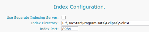

Just got off with support. The issue has to do with the hotfix for 21.2.68 causes the uplift from Solr 8.11 to Solr 9 to fail.
Steps to avoid the issue.
Check that Java is at 11 or higher.
In Control Panel - Programs and Features uninstall Solr
Open the Server configuration and get to the index page to locate your index folder
Rename it to something like SolrSC old
Open C:\Progam Files\Astria Solutions Group and rename Eclipse Solr folder
Run the install and when it launches it will rebuild the two folders and the indexes.

I rebooted after Solr uninstall, got into the Sever Config and renamed Index location, and leaving Server Config open, got into File Explorer and renamed Solr folder, then finished the Server Config. Got a new Program Files Solr folder, but not a new Program Data Solr folder. And the error is still there.
So I went back in to the Server Config and changed the folder back and clicked the Index checkbox
Now it works.
