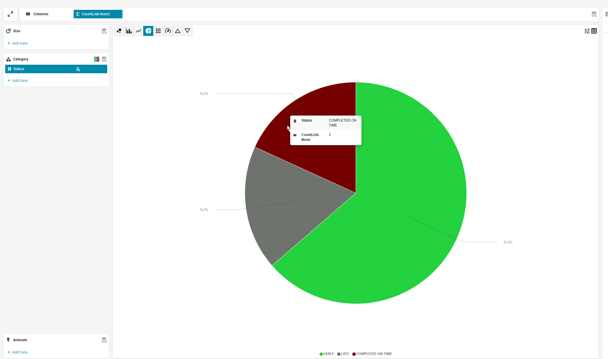

I have a Pie chart in EDD that shows on-time and Late Data for Operation completion.
In EDD, I selected the Status column as Category and Count Job number in row, but still it is selection color base on the value.

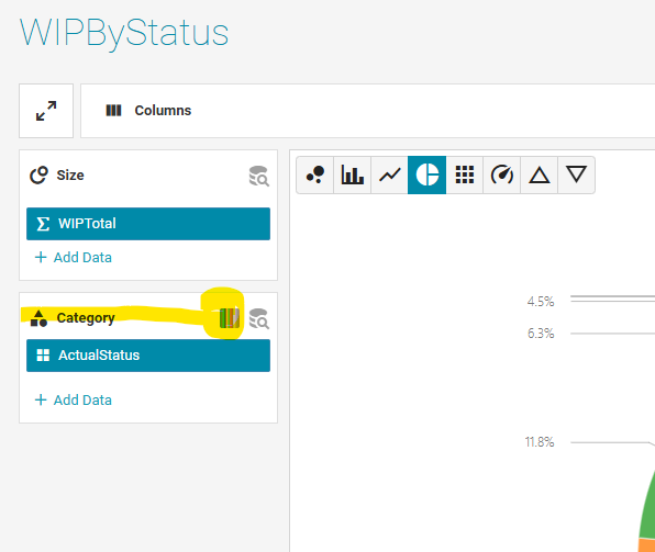

Ahhhyes… good ole EDD and the colors.. I think you might be SOL, however there is a little color picker here that you can choose another color style. It won’t let you set them definitively though.

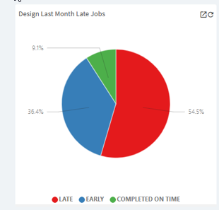

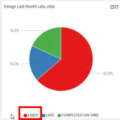

If you see here this one is March data where late job is 8 so it is red, now please see April data.

I have this type of color option here:
D3 Categorical
D3 Diverging
D3 Sequential
Qualitative Series
Quantitative Series
Aging Series
KPI
Highlight Good
Highlight Bad
