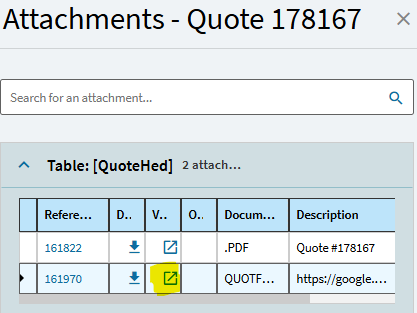

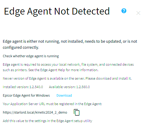

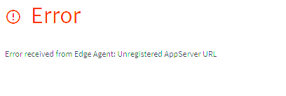

Sometimes, we put a web link in a Document Attachment. We’ve noticed that if we try to launch the page here:
We get this message when the Edge Agent isn’t running.

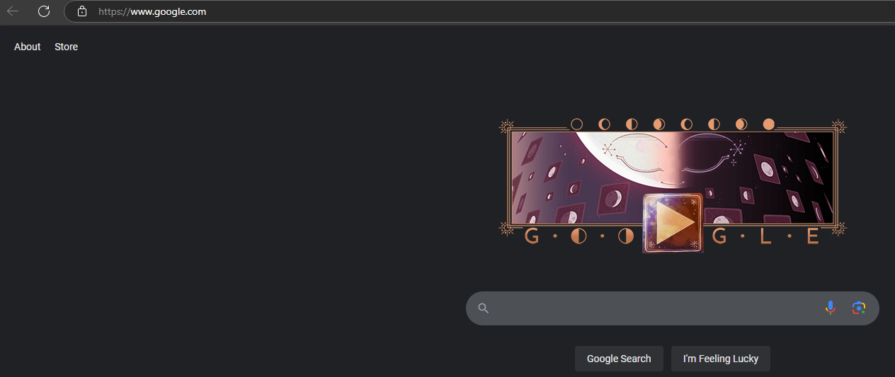

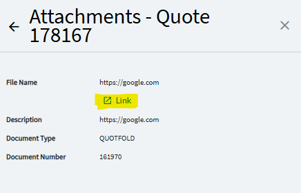

But if we open the attachment, and launch from here:
It opens the page without the Edge Client active.

Is the Edge Agent required to open links on the Internet when opening them as attachments in the browser?

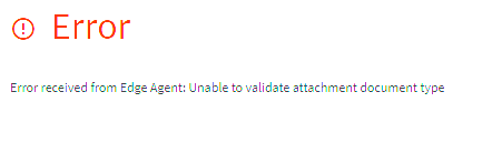

I get
then this

I installed the agent and for the same link attachment I now get
Just like you I click on the file to see the attachment details then click the link then the web page opens…

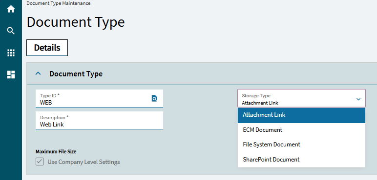

Oh, there is. We use it all the time. You need to create a Document Type for it.
There is actually an EpicCare KB article on how to do this:
Add web links as attachments - KB0106846
Wow; that’s very cool, are you ECM? the only thing in my storage type drop-down is “File System Document.” Maybe I don’t have something enabled. (… enters rabbit hole).
If you have the Document Management license, you should see the different storage types. You need to buy the SharePoint or ECM licenses if you use those products (and probably the same for Google Drive and DropBox). But I seem to recall that Attachment Link and File System Document (on-prem only) should be available to everyone.
I’m seeing this all now, thanks for the above link. I’m working on testing it. I’m always learning something new here, thank you! I
Did you use a Document Type that uses Attachment Link as the storage type?
@Mark_Wonsil

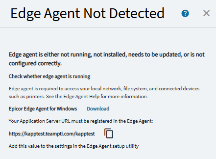

Okay, now that I’ve set this all up, I got the Storage Type Web Link Working for attachments (thanks again!). I can 100% confirm that if the Edge agent is not active (or installed) it will not open the web link.

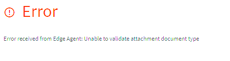

I get the same error as everyone else. As far as did it work before the .7 update, I’ll never know! :rofl: Sorry!
It works if you click on the Reference ID and then the Link in the slide out for me:
Just not in the full Document List:
Is that also the case for you?
Yes, absolutely it does, if I click on slide out “link” it opens right up without the agent.

Just to clarify
Edge Agent not installed:
  • Click on the view column icon and you get prompted to install the edge agent
  • Click on the reference the slider opens and you click on the link and the added url gets opened in a new tab
Edge agent installed.:
  • Click on the view column icon and you are not connected to the edge agent you get prompted to connect or if you are connected I get an error
